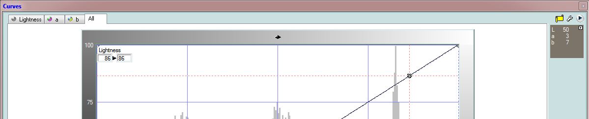

DougS
Posts: 32
Joined: Sun Apr 19, 2015 1:49 pm
Re: new install won't work - not registered
Postby DougS » Mon Feb 12, 2018 3:13 pm
Thanks Greg, but does not seem to work. Have restarted CM and Ps several times. Have tried turning Hue Clock off, w/wo text; no change.
See attached .jpg screenshots.
I went back to old win7 PC (same 3.8.2 CM ver.) and sure enough the hue clock is there tracking my mouse pointer position to display hue clock and Lab (set that way) color numbers.
Any ideas? or is this a new bug?
Doug

Posts: 679
Postby gregmeister_admin » Wed Feb 14, 2018 5:57 am
Doug,
Do a search on your C:\ drive for "Curvemeister.8bf"
Let's see if you have multiple copies. You should have at least 2. One in the Photoshop filters folder and one in the Curvemeister folder.
Once you find them check the file size. Your install appears to be corrupted. if you can find both try to copy the one from the Curvemeister folder over the one in the Photoshop folder. if that does not work we can get Mike Russell involved in trouble shooting your install.
I'm tagging him with this thread so he sees your issue.

Postby DougS » Sat Feb 24, 2018 4:44 pm
See attached jpg
Looks like I have an extra version installed? in Ps
Which one is best to disable/remove?
Doug
Posts: 679
Postby gregmeister_admin » Sun Feb 25, 2018 6:47 am
The one in the Curvemeister folder is the backup in case you have issues. That is the one you can copy over.
replace the copy found here:
C:\Program Files\Adobe\Adobe Photoshop CC 2018\Required\Plug-ins\Filters
The other copy should be removed.
Let me know if this does not resolve your issue.
