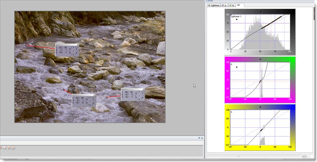

Brian,
The image seems to be too bright. I would re-threshold the image and see if you can get more contrast range into it.
I have attached a curve file for you too look at. When you have opened it switch to the A channel and make the curve bigger than 1/2 of your screen. The neutral I set is not enough to get rid of the color cast. you still have to adjust the A channel a bit.
I used the saturation slider before I did this to make the color cast stand out a bit.
- screenshot004-jpg-41 (84.99 KiB) Viewed 4088 times
