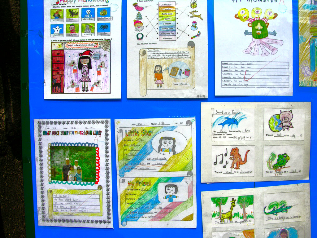

Again, I didn't do anything extra to these. Just used Curvemeister.
I added a screenshot of the drawings in RGB for comparison.

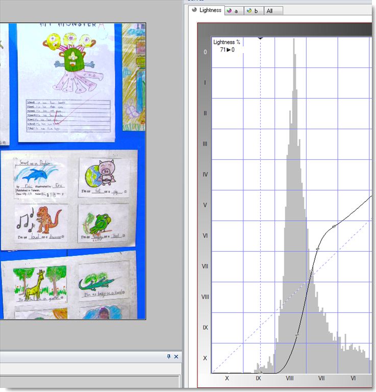

Can you find the place on the L curve where the type lives? that is where you need to make some changes....Try to get the type to be more pronoounced without hurting the rest of teh image...You may have to re-saturate after your lighting correction.
This is a pretty ugly curve. Am I going in the right direction. The writing is darker.

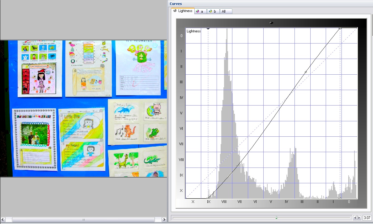

In Shot.jpg I have your ACV file as posted..

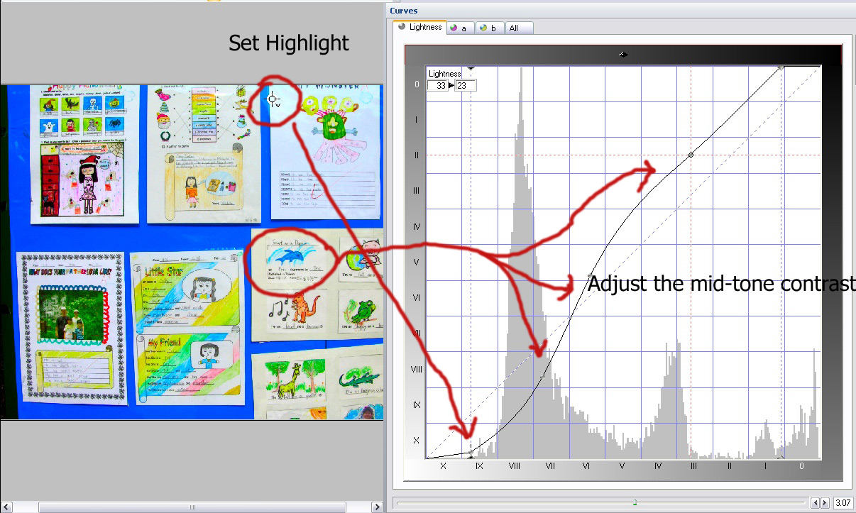

In Shot 1 I have some suggestions...
Set a highlight point and try to make the threshold from that single point. Note the change in the curve window...
Then Adjust the mid-tone contrast by making an s-curve in the middle as shown. The S curve will increase the contrast across the selected area.

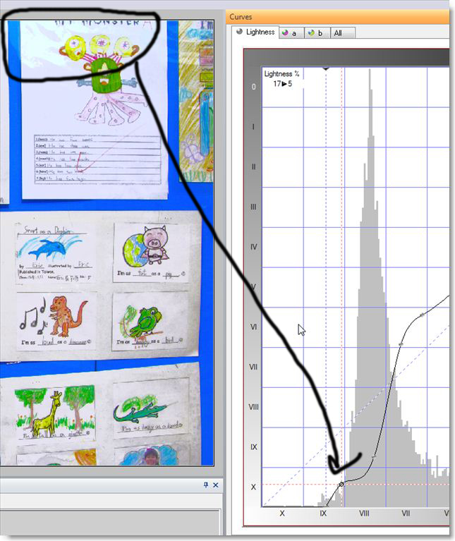

One of the faults of CM is that the "highlight worm" is the same color as the highlight you are looking for. Many times it is very hard to see. It is in there you just have to look very carefully...When I found it in your image I knew what needed to be moved...The bottom of the L channel has a flat area where the curve is smacked up against the frame of the window. When you lift it off watch the area of the image I have circled...You should see the highlights shift in response to the curve...
