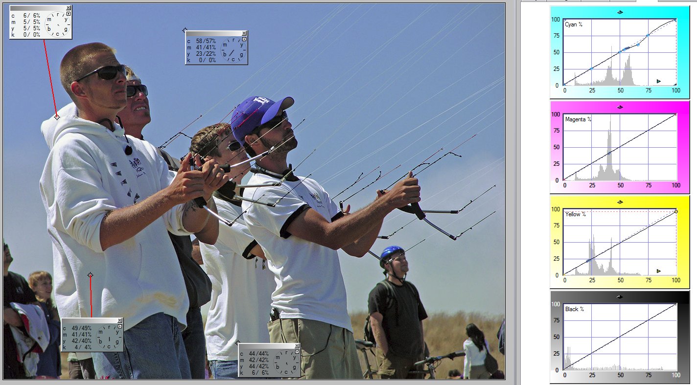

Step one was to go with the default setting in shad/highlight
Step two was work on blue curve,two points,reflections on shirts,then sky color
Step three,added a little punch,and some blue, with HSB.  GregM

Postby mikemeister_admin » Thu Oct 08, 2009 2:51 pm
Masked the sweatshirts and removd some blue.GregM
(added red and green)

Postby ggroess » Thu Oct 08, 2009 4:46 pm
Much better process....
This is without a doubt one of the toughest images in the class...It really belongs later in the course....
The bottom of the front guys shirt looks a bit odd but maybe you can adjust the mask a bit and smooth it out...
Great correction Greg...Gives us all something to shoot at...
Postby mikemeister_admin » Thu Oct 08, 2009 6:52 pm
This removes the hint of yellow the red and green induced and a smidgen more of the  blue.Barely perceptible.Tail in sight,increase speed!GregM

Postby mikemeister_admin » Fri Oct 09, 2009 7:19 pm
Thank you,I've done this image several times and have benefited from the efforts of others in previous classes.I try to get good skin and clothes colors for the little girl at about 8 o'clock,also the strap on bikeboy's chest shows if you've got contrast under control.GregM
