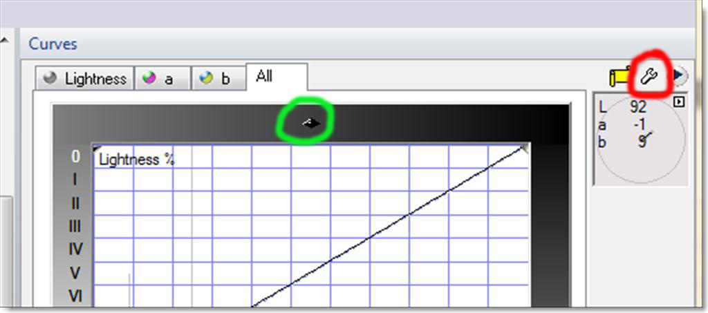

To get to the config. quickly you can click on the wrench Icon. see shot7 The green circle is the switch to flip the grid over addressed below under config.

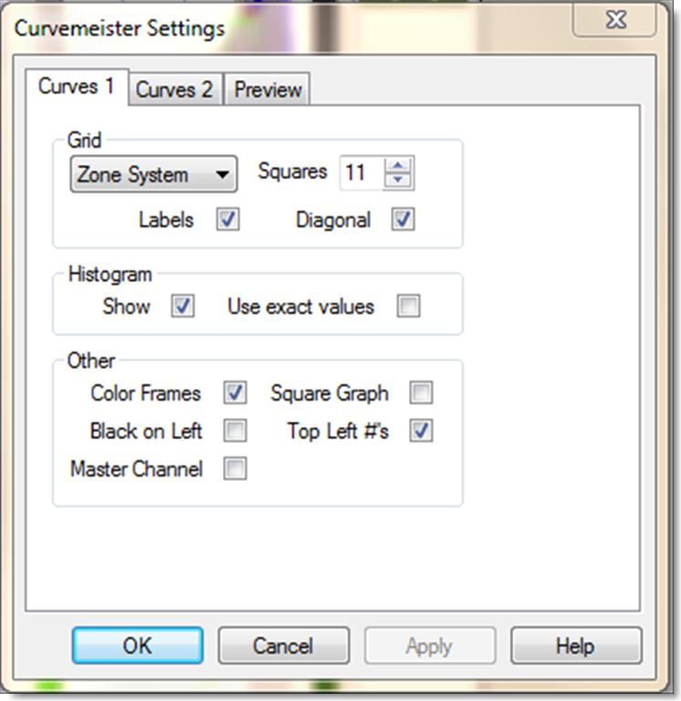

Shot4 is the first screen: These are basic settings and certainly are not required..I noted your use of the zone system and I too use that in LAB...

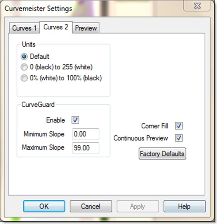

Shot5 is the second screen: I turn on the curve guard and leave the default settings in place. Curve guard warns you when you are creating curves that are out of Gamut for the color space you are in. In LAB that is very easy to do.

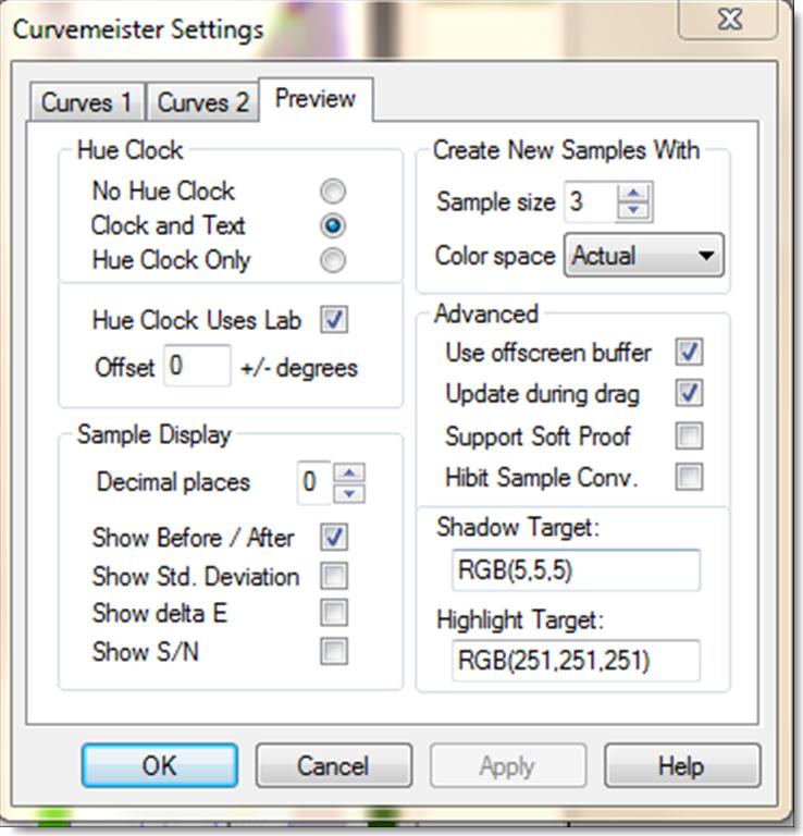

Shot6 is the real meat of the config screens...
Note the shadow and highlight target values. These help you make sure that all of the shadows and highlights are printable. It acts as a limit on the darkest shadows and the brightest highlights. Quite useful settings really....
Additional note: The Sample Size...This is the setting that CM uses to determine the values for the pixels under the mouse pointer. If yours is set to 5 or above it might be leading you to make different decisions regarding color. the 5X5 sample uses 25 pixels there could be more blue pixels in the sample and that would make you adjust more red if you set a neutral based on that sample. I use 3X3 unless I have a specific reason to change. There are some techniques where we want a larger sample size to help us define the color contrast range...but that is for a later lesson.

One other thing to note you have the shadow and highlight sides of your curve windows mixed for instance the LAB setting for shadow is on the Left but the Shadow for RGB is on the right. It will reduce confusion for you if you are consistent in this setting. It matters not which you choose and they are easily changed but you might want to be consistent. just hit the switch circled in green on the first screen shot.
