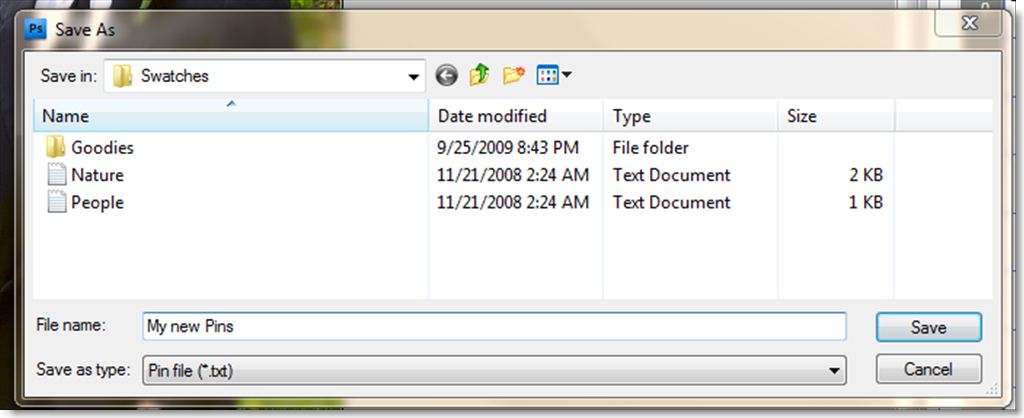

Now the pins files. The boxes are unchecked. I think something weird might be happening cause I cannot even see goodies or swatches in my directory. The only way I can get to them is to do a search.
what I can see which may help is curvemeister.com is read only, curvemeister_3_elements is read only, swatches is read only, goodies is read only, stuff in goodies is not read only. The pins I have installed I have moved out of goodies in the past but this does not seem to have worked with the new skin pins.

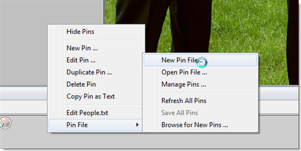

ok...Work Around....
Create a new Pins File and Call it anything you want...Shot1 and Shot2.
Copy the text from the Pins file you have and paste it to the new file you are creating.
Save and exit. Should work...
