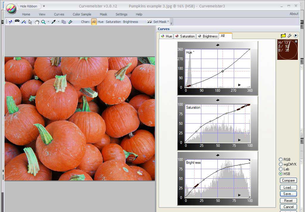

Joann,
On this one you need to start in the Saturation space and play around a bit the Idea is to make the pumpkins look rounder by adjusting the saturation. When you desaturate the image too much the pumpkins look white and sickly...when you kick it just right you can get tones of color and shape...
Start in Saturation..then adjust the brightness slowly and lastly adjust the hue to keep them from turning too yellow in spots....
I'll post my version for you to look at but remember that you can probably surpass me on this one...

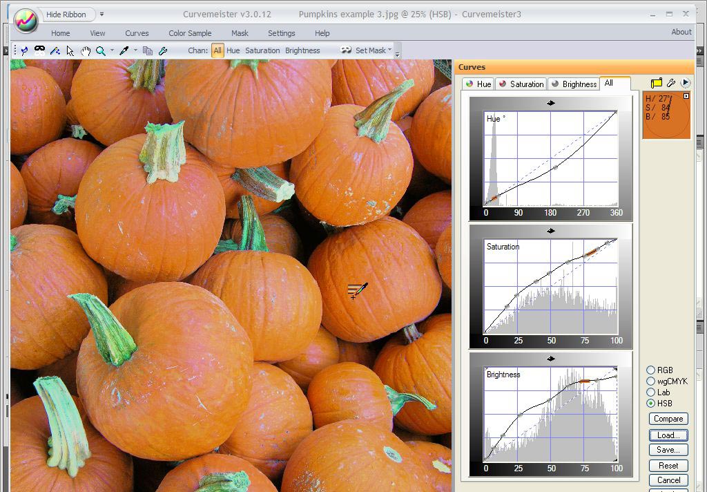

Greg, here's my 4th try on the pumpkins.....I hope you are not getting sick of me.
I think this looks better but I've stared at them so long I don't know.
One thing that is driving me nuts is the pink cast that I can see in the highlights. Also, in the upper left corner there is a pumpkin that has a lavendar cast in the highlight.
