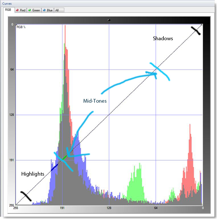

Julie, From your screen shots you are correct...the shadow side of your curves is the lower left.
Anything above 64 and less than 192 or so is generally considered the mid-tones. When I talk about the shadow end of the curve I'm talking about the last 1/4 of the curve from 64 down to 0 on the RGB numbers along the side.
Generally, I keep the highlights on the Left side of the curve. Yours are on the right so you will have to invert any lightness curve you see from me. White is highlight and Black is shadow...
I have made some marks in black near the ends of the curves...This is again, generally the usable part of the curve...anything brighter than the black line on the highlight side and darker on the shadow side is usually not a printable color. It falls into the very extreme areas of the curve.
At first this is confusing stuff but hang in there it gets better and your images will too...

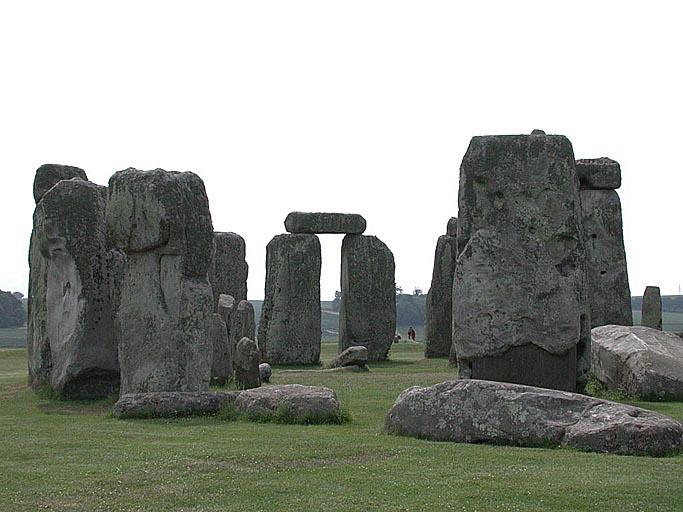

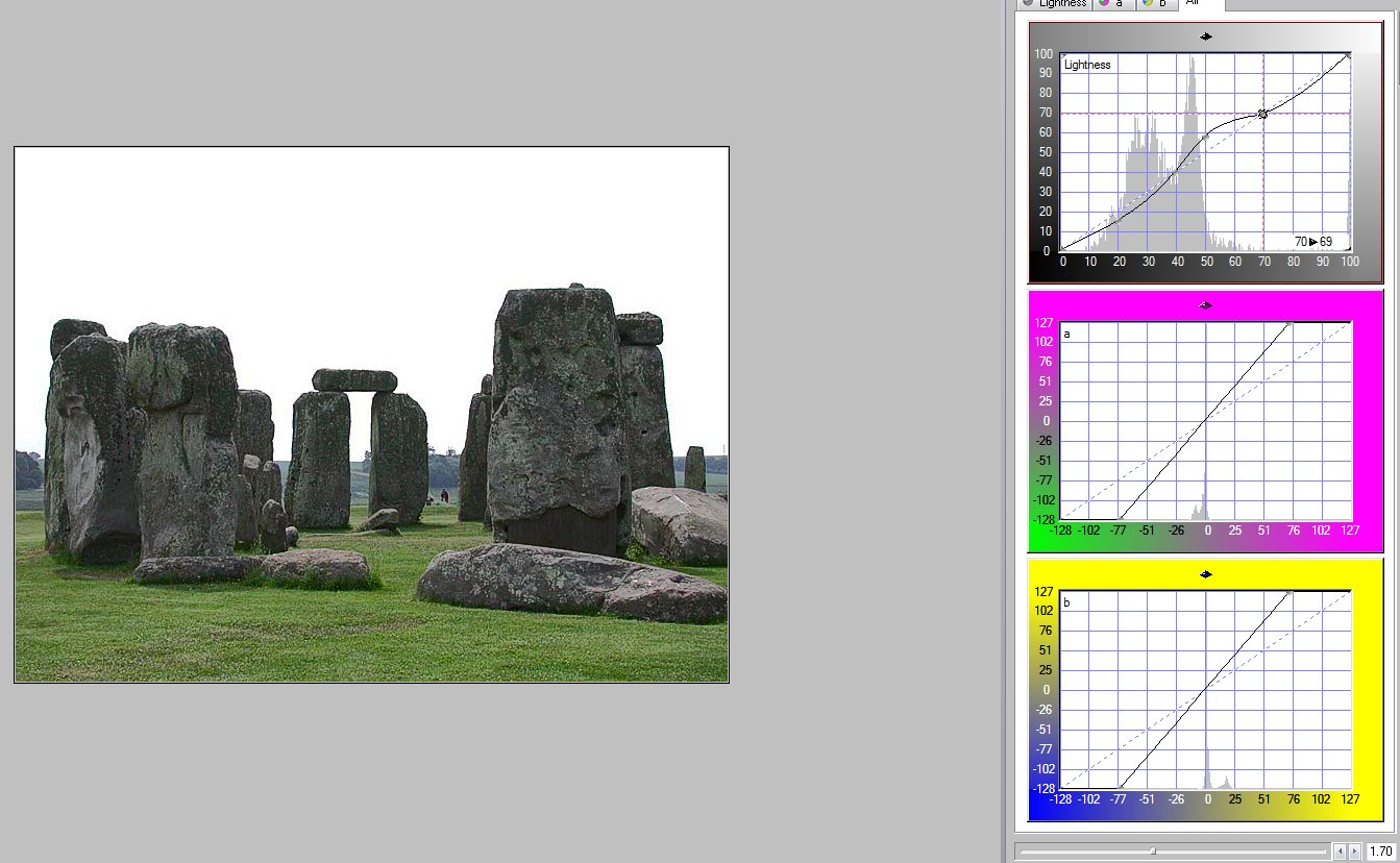

Julie,this is how I learned about control points,image is from Curvemeister example file.When I look at the histogram I see two areas with a lot of activity,so I take a guess and straddle the meaty part of the peaks with points(50,90?128,inRGB)
In the shadow portion I'll frequently follow the angle of the far left side of the histogram a bit,you could also just threshold the shadows.If I the lift the point at 128 I'll create a classic contrast S curve.All these points can be shifted and tested for effect,but be careful in RGB colors can shift.The point at 179RGB,70Lab controls the tiny details on the horizon,lift the point and they disappear.In RGB the flat spot from 128 to 179 is what you don't want and is probable responsible for the flat color and lose of detail on the large flat rock at 4 o"clock.The spike up the right side of the box is the sky and could be lowered but the image is already pretty grey.GregM
