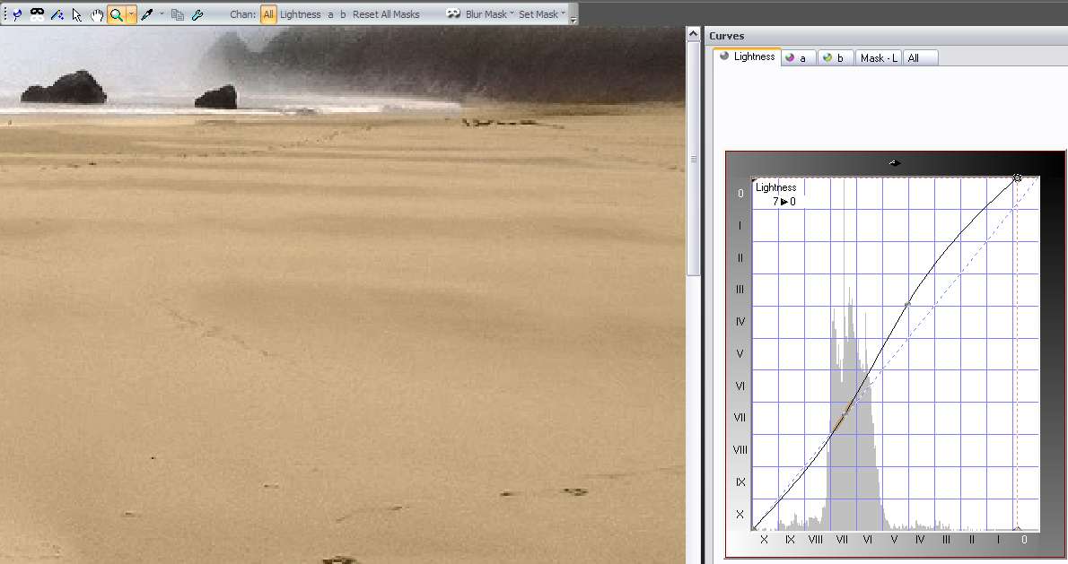

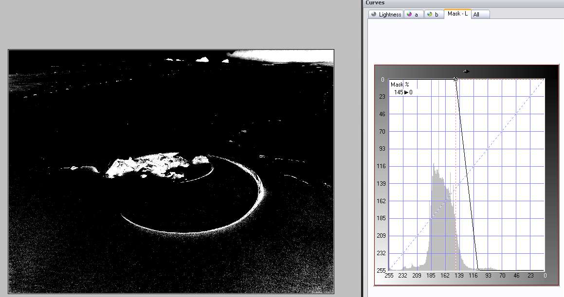

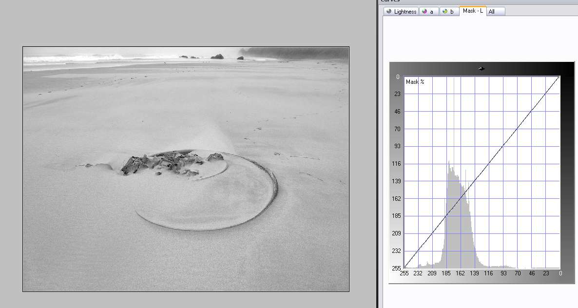

I'm not sure how much more detail you want to bring out there the fog is patr of the problem...When I go after more detail in the mountains I use a mask in CM.  We will be getting to that stuff in the next few weeks but the basic procedure is to open the image in CM:
Click on the mask Icon and select a channel to mask from...In this case the best I found was the L channel.  shot1
You can adjust the Mask channel in CM to Isolate the mountains and make a contrast move on the regular L channel. Select the Mask-L tab. shot2
The problem will be the ring and anything else in the mask that is white will also get some of the adjustment.  Shot3
The lower resolution of the image does hurt this a bit but you get the idea.... Shot4
shot1-jpg-96
shot1-jpg-96 (32.48 KiB) Viewed 13917 times
shot2-jpg-32
shot2-jpg-32 (65.32 KiB) Viewed 13917 times
shot3-jpg-11
shot3-jpg-11 (72.81 KiB) Viewed 13917 times
shot4-jpg-5
shot4-jpg-5 (67.92 KiB) Viewed 13917 times
