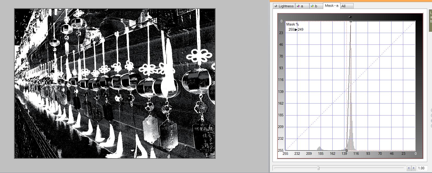

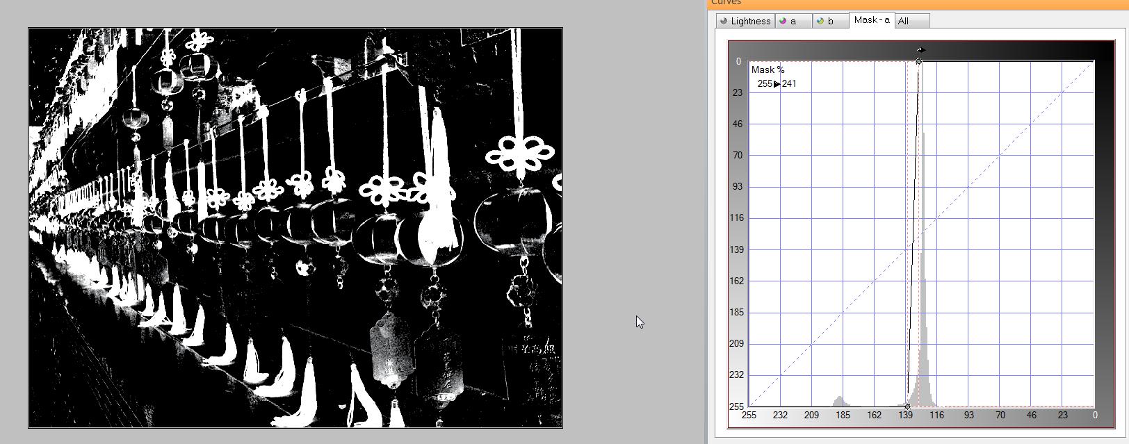

The red reflections can be removed by not having too much contrast in the mask.  Instead of getting it to a hard edge...let the edges of the mask layer "bleed" over a bit.
Shot1 is too "hard"
Shot2 is a bit softer...allowing the mask to "bleed" into the other areas

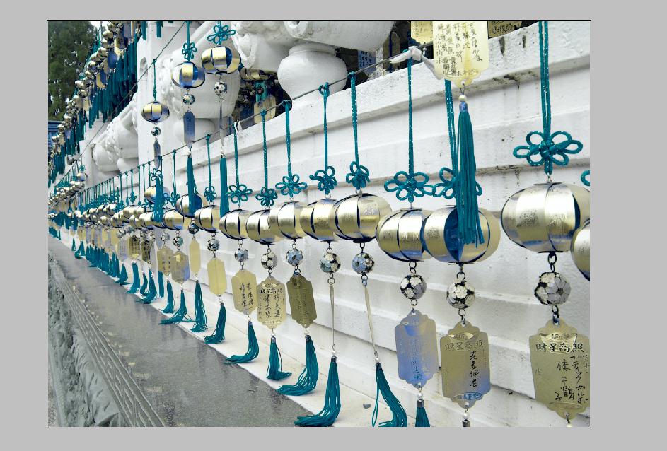

Shot 3 is the image with shot 2 applied...
screenshot001-jpg-81
screenshot001-jpg-81 (167.6 KiB) Viewed 17724 times
screenshot002-jpg-61
screenshot002-jpg-61 (227.99 KiB) Viewed 17724 times
screenshot003-jpg-32
screenshot003-jpg-32 (112.2 KiB) Viewed 17724 times

I see that it is not a huge difference in the mask line between shot 1 and 2 but just enough to show that you removed all reflection on the stone wall. I'll give it a whirl.
