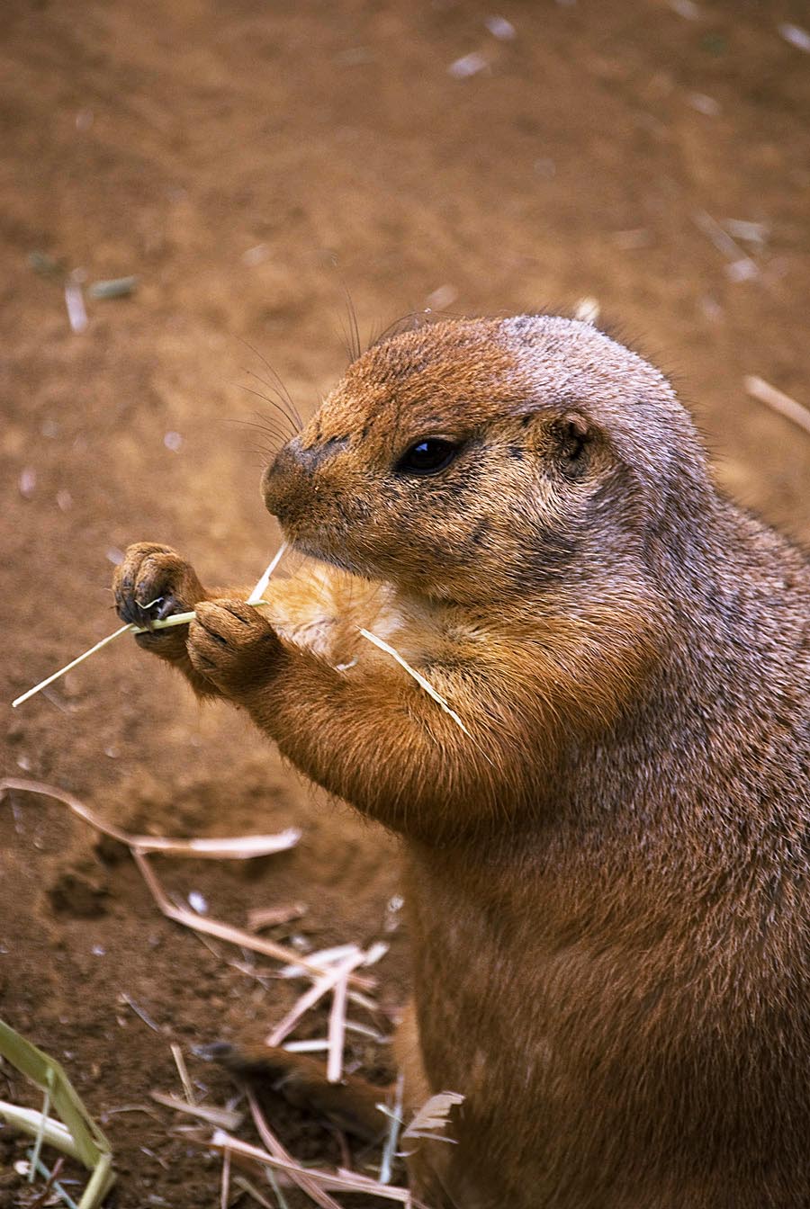

What can I say...he's brown...
Make him look better and see if you can hold onto the details...
a study in brown...

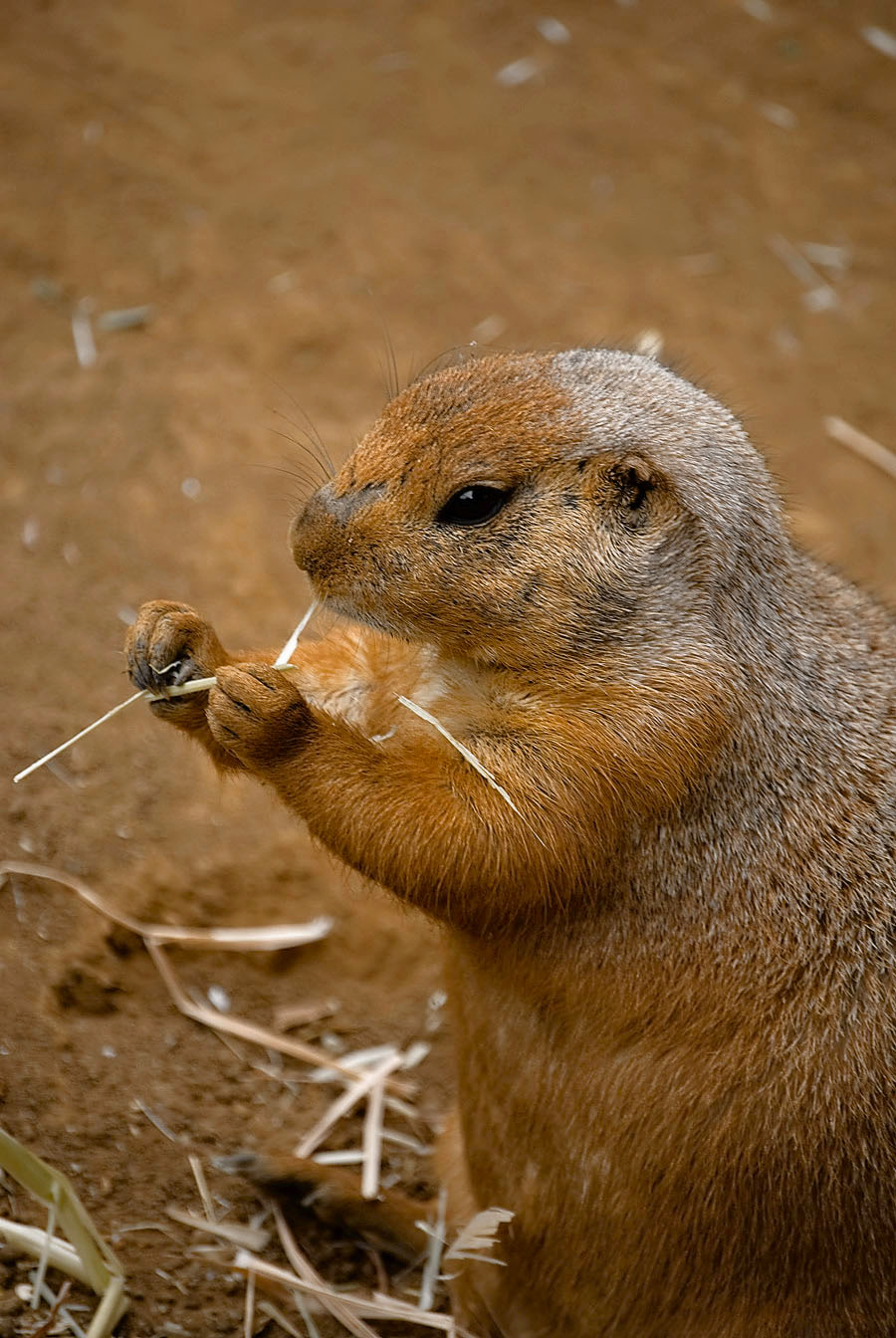

1 noise reduc,then shaping the lightness line to separate the critter from the background,kind of a s plus s curve to get highlights to fur on back
2 s curve across narrow spike of sat histogram in HSB.primary color correction
3 MCP freebie hi-def action
4 slight color boost in Lab to make up for transmission losses.GregM
- brownie-copy-jpg (240.76 KiB) Viewed 14849 times

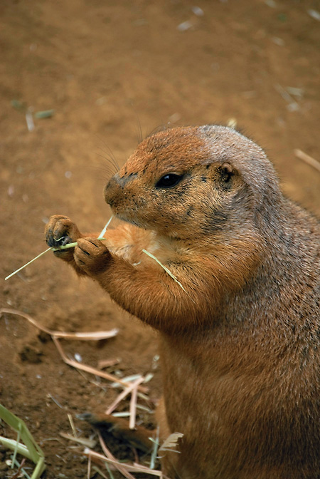

This is my first attempt...
I think that it's a bit heavy handed (on reflection the saturated areas of fur seem a bit too vivid, and the dark area of fur at bottom-right a bit too dark), so I will have another crack at it later on. In any case, here's what I did to this one:
As I say, I'm not totally happy with this version, so I'll try it again later...
As a newbie I've a request to make of those participating in this week's challenges - would you mind saving and attaching the curves you use to create your versions? I loved Ganna's Water Lily yesterday, but could not get close to emulating it, and I think that being able to apply and tweak other peoples curves is the best way for me to learn how to write my own. I've always found writing curves really difficult so I'd really appreciate looking at the curves written by people who know what they're doing :)
- In Photoshop, I blurred the picture to find an average colour value for the fur (using Lab values I got A: 8, B: 16)
- In CurveMeister, I applied a 'Man from Mars' curve to enhance colour variation (see attached curve file).
- Back in Photoshop I cut back the opacity of this 'Man from Mars' adjustment to 20%.
- Back to CurveMeister to play with the HSB Saturation curve (see attached). I wanted to separate the animal from the background, so I cut back on the background saturation with a 'Low Shoulder' curve.
- Having more-or-less corrected the colour, I applied (in another pass) an S-curve to the L channel - having used the 'Mark' option in the contextual menu.
- I also wanted to multiply the Black channel into the image, and tried to copy the K channel (from the Masks palette) by clicking the clipboard icon in the ribbon bar. However, this didn't work (perhaps I didn't go about it properly), so I had to do this in Photoshop.
- I finished with two applications of Unsharp Mask - 1) USM 30/20/10, 2) 150/0.3/10
- brownie_lh_1-jpg (132.55 KiB) Viewed 14849 times
- brownie-jpg-manfrommars-acv
- (62 Bytes) Downloaded 647 times
- brownie-jpg-saturationcut-acv
- (62 Bytes) Downloaded 596 times

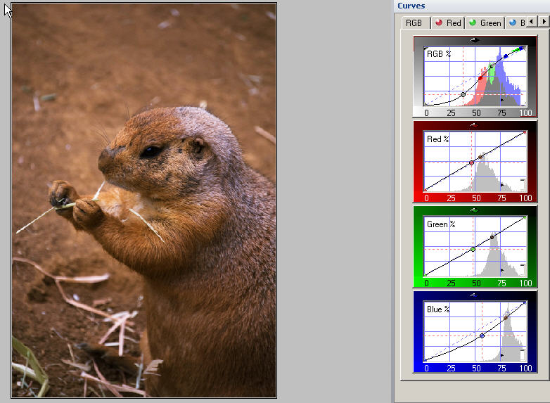

Chris Nicola
- Posts: 11
I moved the blue slider to get rid of the excess yelow. Adjusted the green slider to improve the colour. Then fiddled with he RGB slider to improve the contrast. Opened in PSE and increase brightness +20 and sharpened USM radus 1 at 100%.
I have a question please. What curve would I use that is comparible to the brightness slider in PSE?

Well, I've had another go, and I'm much happier with this version...
I still began with a 'Man from Mars' move, but I worked this version predominantly in CMYK, and I like the colour a lot more than what I came up with in my first attempt. As I mentioned before, I'm not used to working in CMYK - but I'm starting to like it :D I found that I could warm up the animal's back (which my 'Man from Mars' curve had made too blue) with far greater precision than in Lab. Also, although I've yet to wrap my head around curving the Black channel, I managed to pull a bit of detail out of it without overly darkening the fur at lower right.
In comparing my second attempt with my first, I decided to blend 20% of my first attempt into my second version (to slightly brighten the highlights on the animal) - but this image is 80% new...
