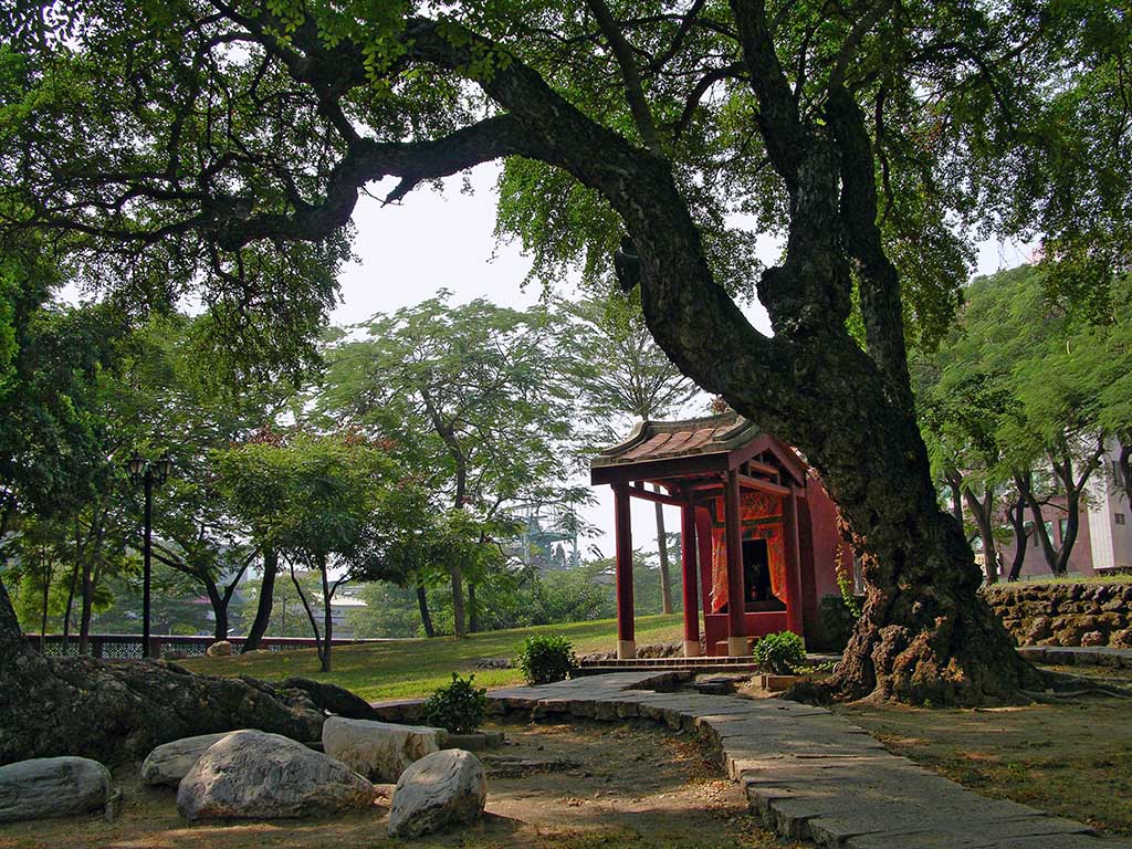

I have found Photoshop's shadows/Highlights command to be very useful. I expected to be able to accomplish the same transformation by adjusting the curves in Curvemeister. I have not been able to do so and wonder why. Take for instance the Taroko Gorge image. If I get aggressive with the folage correction, all detail in the river bed rocks is lost and no adjustment the the curves that I tried would bring it back. The S/H command did it easily. Likewise, when I tried to bring out detail in the tree and rocks in the forground of the tainan-park-of-5-concubines image, I got what I assume to be posterization. Again, the S/H command solved the problem. Is there a straight forward way to accomplish the same result within Curvemeister?

My take is that the answer is "no". The shadows/highlights filter uses a sophisticated algorithm which takes into account surrounding pixels and a number of inputs (the sliders on the dialog). It's a lot more complex, and IMHO, a lot more capable than a simple curve manipulation.
My standard workflow (when I use CM) is to use the RAW filter to ensure the image uses the full range (i.e. no empty gaps at either end of the histogram), then run S/H in LAB mode, correcting plugged shadows and blown highlights without affecting the colours. I then use CM to fine tune the shadows and highlights and to get the colours right.
I usually use s/h(with color correction set to 0) instead of a lizzard tail now.I'm speaking as a hobbyist,not someone who has to satisfy clients or pressmen.GJM
For this image I went crazy with the color slider in s/h.
- 2007-11-park-of-5-concubines-copy-2-jpg (267.66 KiB) Viewed 70295 times
[The extension shh has been deactivated and can no longer be displayed.]
- 2007-11-24_105050-tainan-park-of-5-concubines-copy-2-lab-acv
- (78 Bytes) Downloaded 2631 times

Ok, darkening highlights... Before you read this, take a look at the image I've attached.
The top image uses the Shadow/Highlight command to darken the highlights (the amount slider is cranked up to 100%). I couldn't find a better example image. It could be argued that S/H makes the boulders look ok, but as you can see from the version underneath, there is more that can be done for them.
The bottom version is a very mild application of Dan Margulis' 'Overlay blend' technique. There are some videos at KelbyTraining that explain the process (www.kelbytraining.com/instructors/dan-margulis.html), but you need a subscription to watch them, so I'll give you a brief outline of the process.
Lets take this image. We need to take a look at the channels (so, as far as I know, you can't do this in Photoshop Elements). Select: Window > Channels if your Channels panel is not open. Click in turn on the Red, Green, and Blue channels - one at a time. We are trying to find out which channel (in this case) contains the darkest trees and the brightest boulders. In this image the Red channel is the best choice. Having determined this, we are ready to blend:
You will now have a B/W layer (a copy of the Red channel) at the top of your image's layer stack. Invert this layer (Image > Adjustments > Invert). Doing this will make the trees light, and the boulders dark. At this point there are only a few more things to do:
Changing the blend mode of our layer to overlay will get you back 'towards' a normal image - but it'll make the image look (temporarily) awful. Don't worry about that - there's just one final step:
We need to blur the layer - Filter > Blur > Gaussian Blur. Start with a blur value around 30 pixels, and then adjust up and down to see the effect of the blur (it will add dimension to the boulders). I left the blur at 30 px for the image attached...
This process will mimic S/H - it will lighten the dark areas, and darken the light areas. If you want to completely omit the lightening, duplicate the layer beneath the overlay layer we just created. Place the duplicate above the overlay layer, and set its blend mode to 'Darken'. You can change the opacity of the 'Darken' layer if you want to partially lighten the trees. Another area where you can control the effect is by curving the overlay layer.
It sounds like a lot of work to do this, but in practice it only takes about 15 seconds to do this by hand - and you can always write an action to speed the whole thing up.
Let me know if it works for you :)

- shadowhighlightalt-jpg (298.37 KiB) Viewed 70295 times
