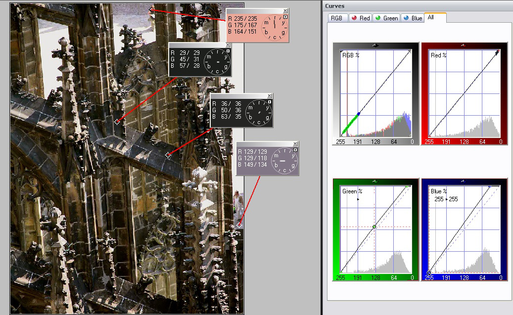

Used L channel to bring out bird droppings on spire,an approach used by several people in previous classes.GregM
Luminosity sharpening set to 25% opacity.

It's nice to see another correction of this image  :)
I've been working with your curves (thanks for attaching them, it's always a real help), and presume that you did your first pass in RGB (to set the white point)... I really like the idea of using the bird droppings. I wouldn't have thought of that in a million years! I also like the drop on the highlight endpoint in Lab - knocking down the brightness of the pavement really helps the image.
Nice work - thanks for sharing  ;)

Greg M,
Interesting take on this but.....
The shadows are still blue...  See hue clocks...your correction also does not address the skin tones in the background.

Added above with different neutral.GregM
Postby ggroess » Tue Jul 06, 2010 8:02 pm
that looks better...I just could not...not comment... ;)
Postby mikemeister_admin » Tue Jul 06, 2010 11:13 pm
Yes,I know.GregM
