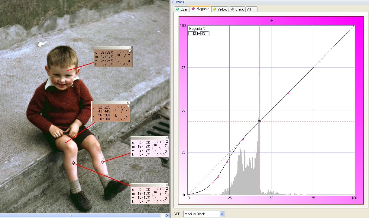

i played around with this for ever. I put in a neutral but there looks like some magenta on his legs and i dont know how to get rid of it

Actually you have already solved the problem you just have to apply it....
Your assessment is correct...The highlights are magenta...With color associated with brightness you have RGB and CMYK as possible choices for fixing the cast...Since the color cast is magenta...only in the highlights... make an adjustment to the M channel of CMYK as shown.
