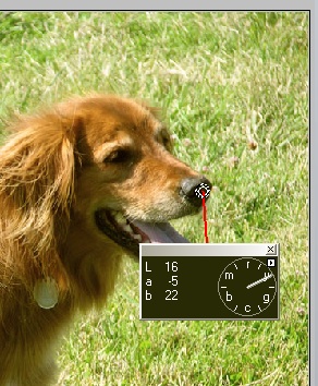

In my screen shot I placed a hue clock on the black nose of our fine doggie....
The Hue Angle tells me the nose is yellow
The Visual square tells me the nose is black.
The numbers tell me the B channel in LAB is warm...Since B channel is yellow/blue I know the image is too yellow. The number I need it close to zero so it is neutral.

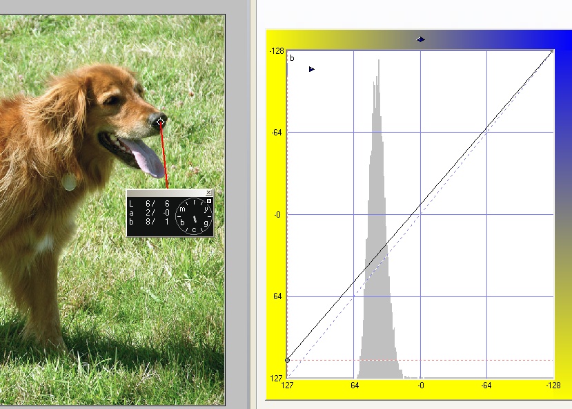

In Shot 1.jpg I have made an adjustment to the B channel and brought the nose closer to a neutral black.
In this case the visual information and the hue angle information do not agree and I really need to pay attention to that...I have a strong yellow cast in the image....Since Grass and Golden dogs are mostly yellow it is easy to ignore this...But it's real and the image looks better to have it removed.
I did move the point between the screen shots...I did not like the correction the stronger values produced...The cast was not as bad as the sample shows me...This is where the aesthetic comes into play...
- shot2-jpg-11 (66.33 KiB) Viewed 12478 times
- shot1-jpg-28 (183.01 KiB) Viewed 12478 times
