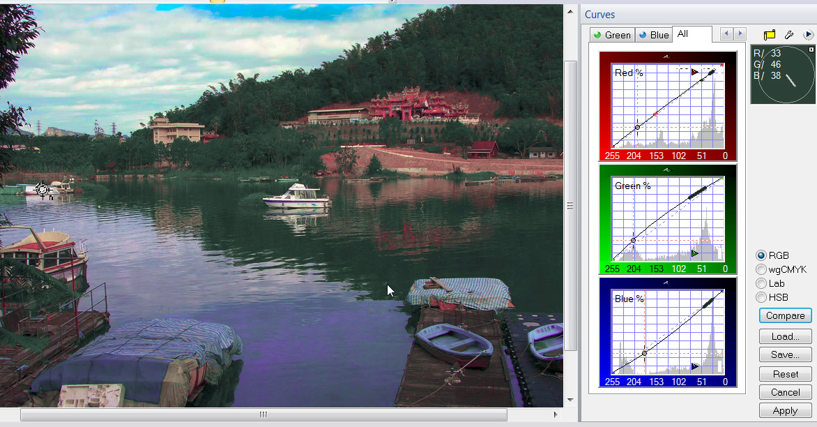

Unfortunately, this issue is sporadic.
I just opened a jpeg in CS5 went to CM. And everything was fine. wgCMYK was an option. It allowed no black, to max black on the gcr. Cool.
Sometimes, (grrrr...) I do the same thing, no cmyk at all. If I use the K mask, no GCR options. If I convert to cmyk, then I get cmyk options, but no gcr (photoshop apparently does not change gcr, only through different profiles). I then convert the image back to RGB or LAB and wgcmyk works but no gcr options.
I have two computers, both running win 7. One is 32 bit and the other 64 bit. For these classes, I only use the 32 bit photoshop.
I will muddle along until I break it or see the real pattern.
It is working now (for today).

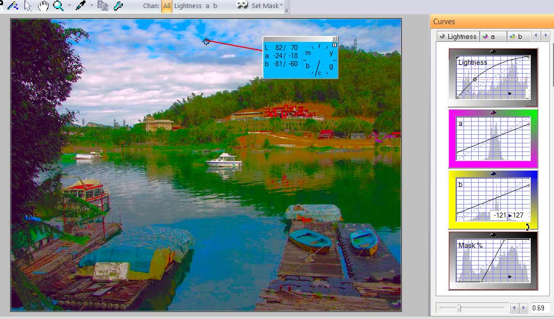

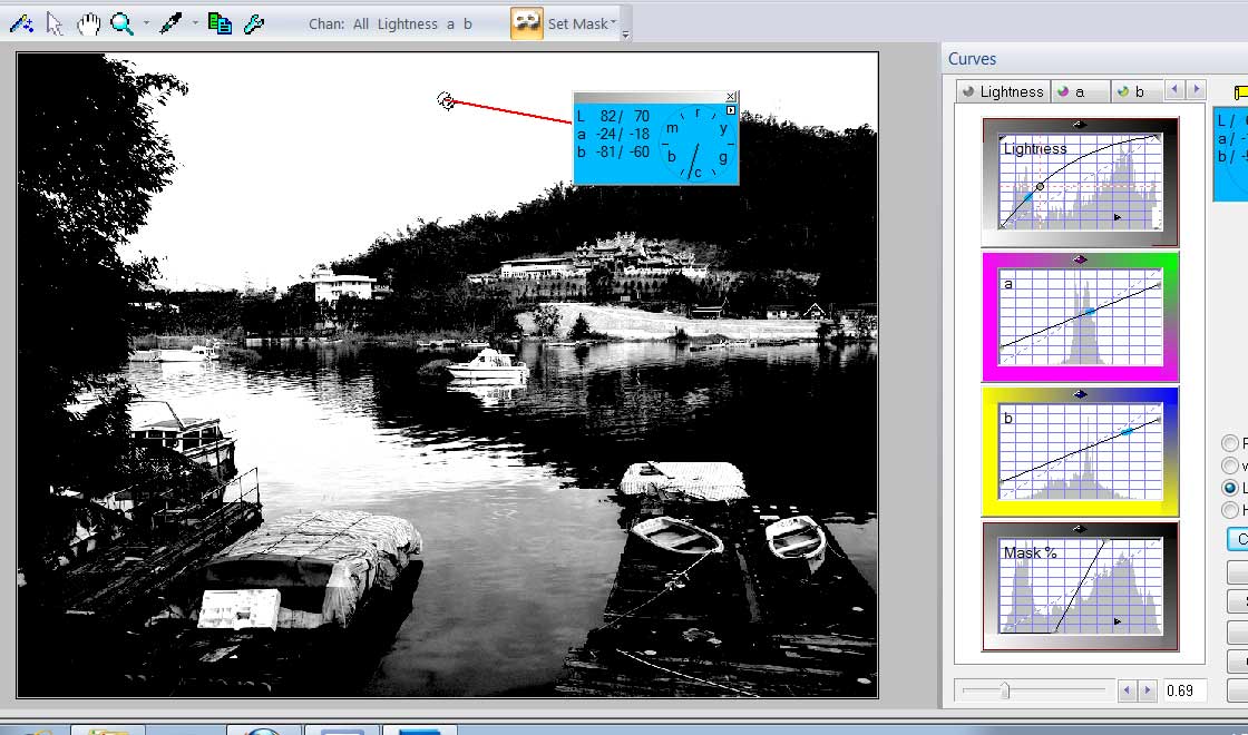

First, fix the image without concern for the sky.
Second, mask the sky, and fix it.
Save the mask, load it in Photoshop and paintbrush the mask to fix.
In general, should you mask an area out, fix that area. then invert the mask and fix the other area?

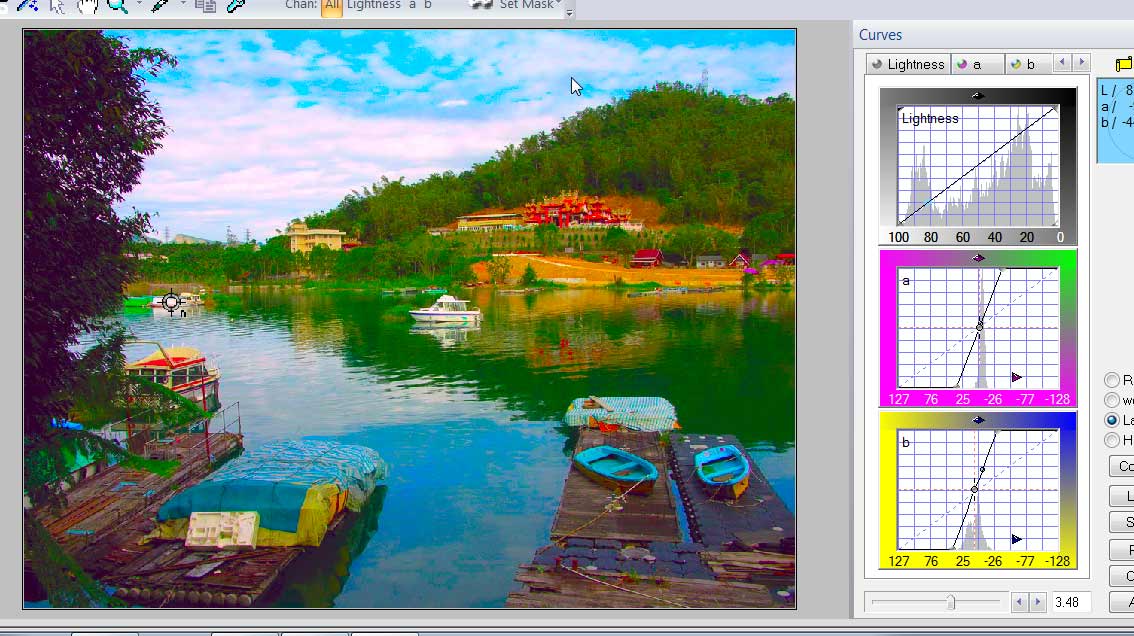

- 52-lake-2-ss1-jpg (116.24 KiB) Viewed 10970 times
- 52-lake-2-ss2-jpg (103.27 KiB) Viewed 10970 times
- 52-lake-2-ss3-jpg (115.2 KiB) Viewed 10970 times
- 52-lake2-jpg (244 KiB) Viewed 10970 times

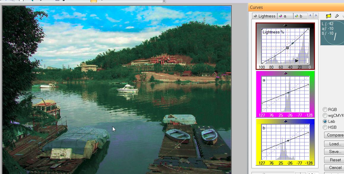

Your image looks pretty good overall but it is too over saturated...Take it into lab and desaturate it a bit and see if the blues and reds are less neon...

Oops. (I am getting tired of saying oops).
The image I posted was with the sky boost but I disabled the mask.
This image is with an inverted mask and corrections made to the foreground. IOW, I masked revealing the sky and fixed the sky. Then masked the sky
