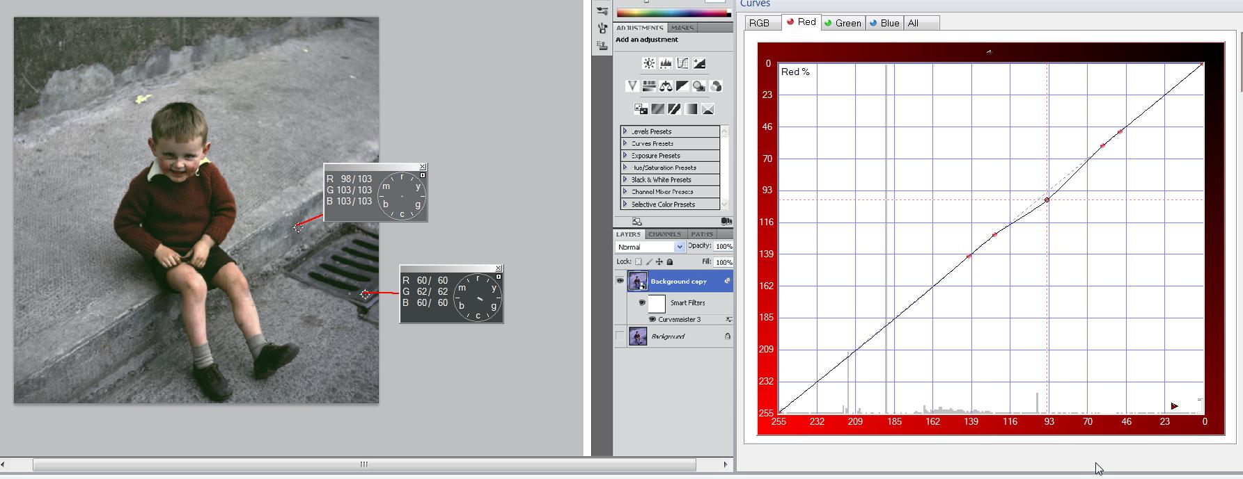

A slight tweak warms this up just a touch and makes the boy look better overall...
I switched to RGB because the cast is linked to the brightness in your version of this image...I know that because I set some hue clocks at various brightness areas and found the 85 - 100 range is where the cast was strongest. Look at the before and after numbers on the hue clocks as shown.
I pinned the red channel above and below that rnage and made a slight adjustment to make the 103 point neutral. It is a subjective choice but the cast is controlled.
- screenshot002-jpg-28 (155.15 KiB) Viewed 14131 times
