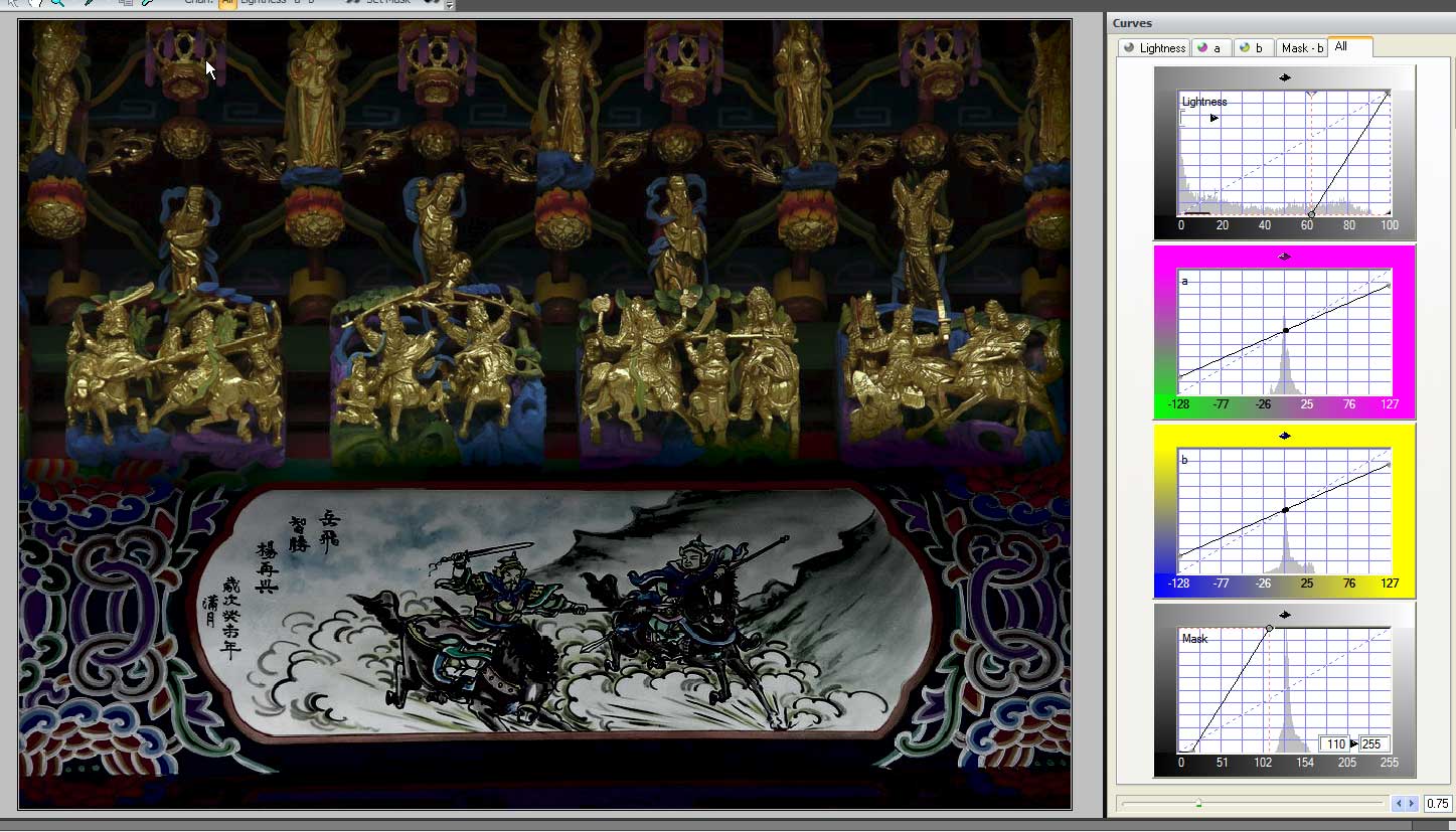

Hello.
I had some difficulty with this image.  I selected the gold to make sure that it would not be dimmed.  I used Lab mode with the B channel mask.  What do yo think of it?
Thank you
David
20110130_example7-templefugures-lab1_screenshot1-jpg
20110130_example7-templefugures-lab1_screenshot1-jpg (999 Bytes) Viewed 36285 times

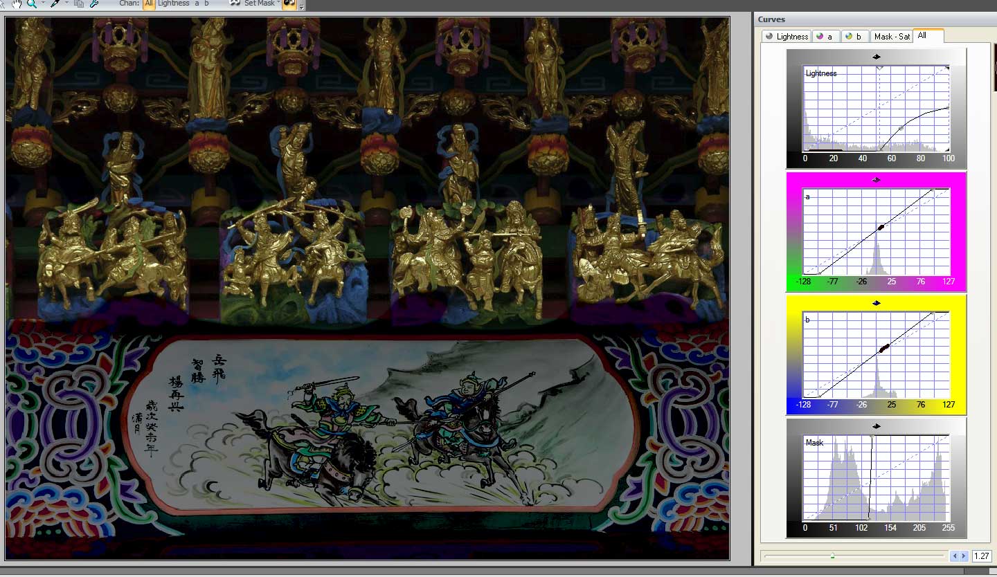

Hello
I decided to try this image again because I really was not satisfied with my first try.  I sleeted the gold along with the top half of the image.  I then inverted the selection.  I  used the B channel as a mask with some adjustments.  I adjusted the L channel.  Finally, I moved the saturation slider to the left rather than the right (applied some desaturation).  I believe this try is better than the previous one.  What do you think of it?
Thank you
David
20110130_example7-templefugures-lab2_screenshot1-jpg
20110130_example7-templefugures-lab2_screenshot1-jpg (173.38 KiB) Viewed 36285 times
Postby ggroess » Sun Jan 30, 2011 9:30 pm
David,
While B is a good choice for this image you can get even further by looking at the saturation mask.  Apply a light to medium blur using the mask commands in CM.  Start by balancing the exposure over the two halves of the image.  Then adjust the saturation using the LAB slider.
Give it another try...

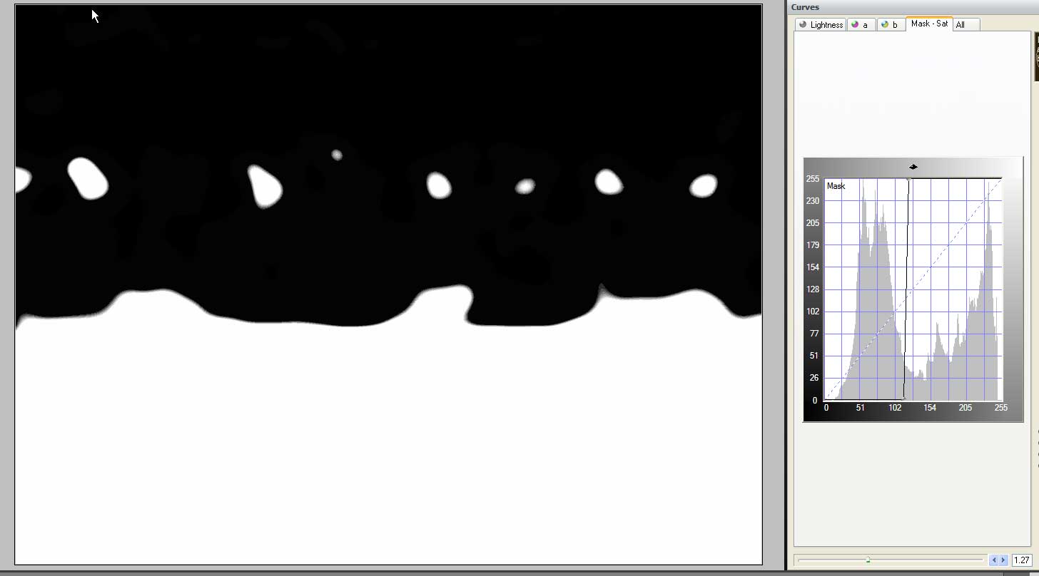

I decided to re-do this image.  This time I used the S channel as a mask with blur set to wide.  I believe this is the best one so far.  What do you think of this image?
Thank you
David
20110130_example7-templefugures-schannelmasklab3_screenshot1a-jpg
20110130_example7-templefugures-schannelmasklab3_screenshot1a-jpg (43.99 KiB) Viewed 36285 times

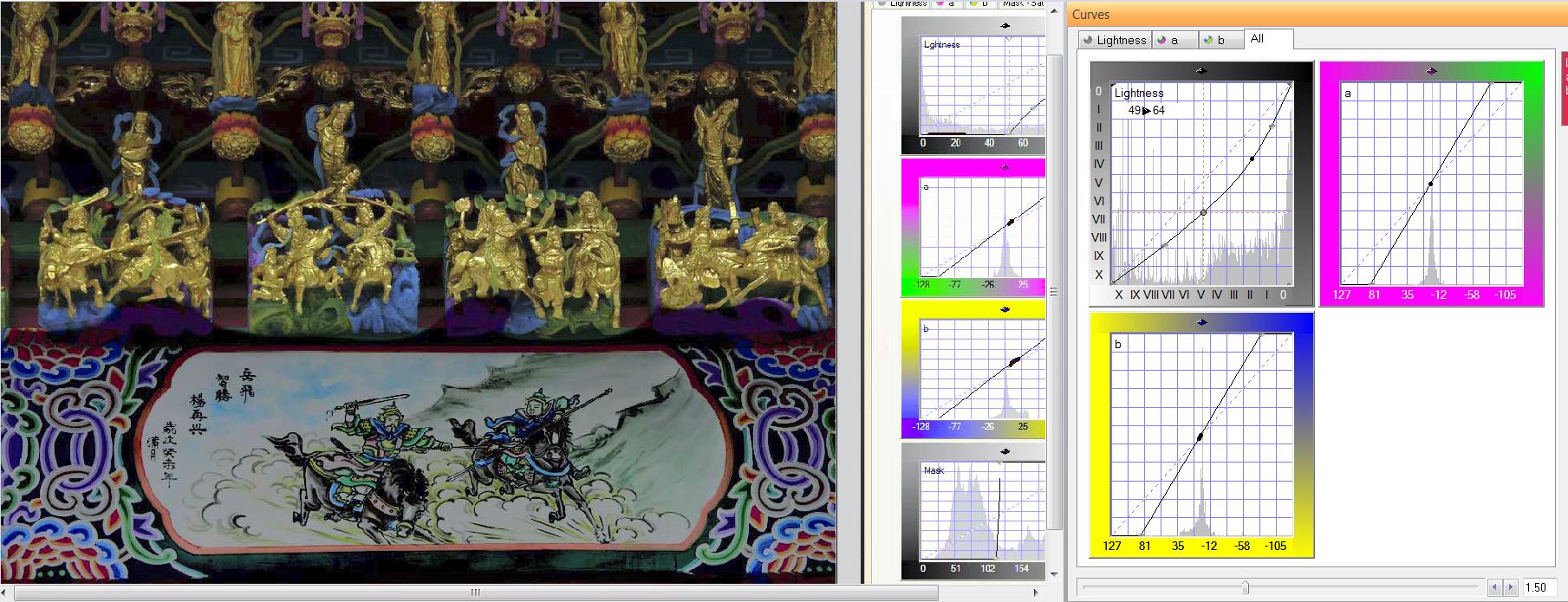

Postby ggroess » Mon Jan 31, 2011 12:15 am
I think it is much better and you can still open the shadows and mid-tones as shown...
Then if you add some saturation you have it...
screenshot004-jpg-3
screenshot004-jpg-3 (252.62 KiB) Viewed 36285 times
