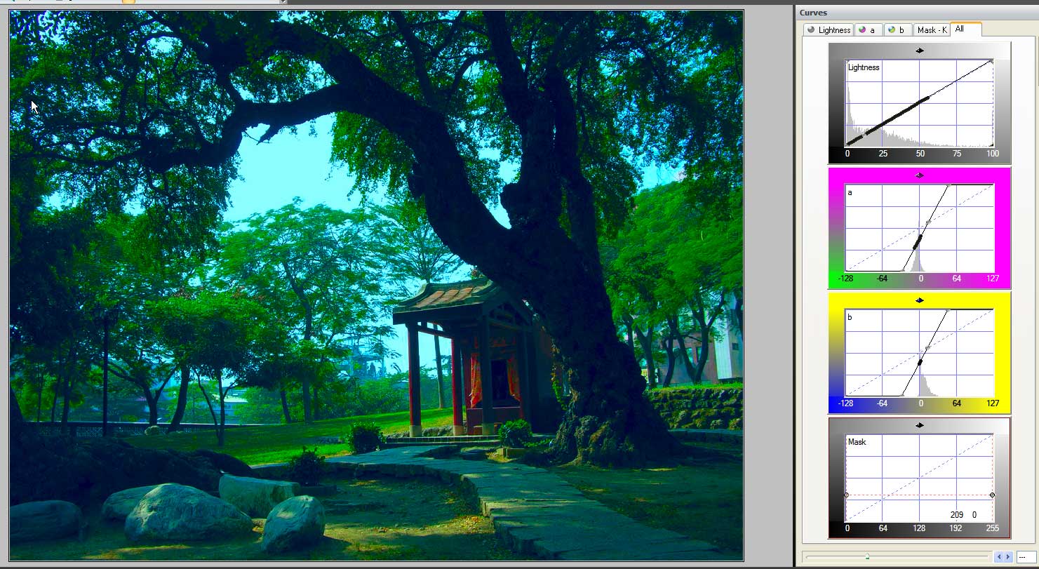

Hello.
I decided to take another try at this image. I set the shadow and the neutral, however, there was no obvious highlight. I then applied the K mask and adjusted it. It looks to like like the greenish cast is a lot better. What do you think?
Thank you
David
Thank you
David

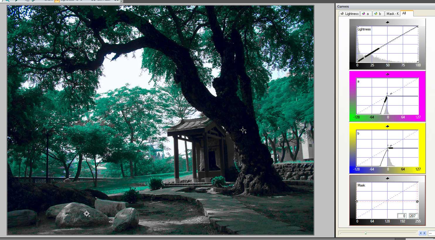

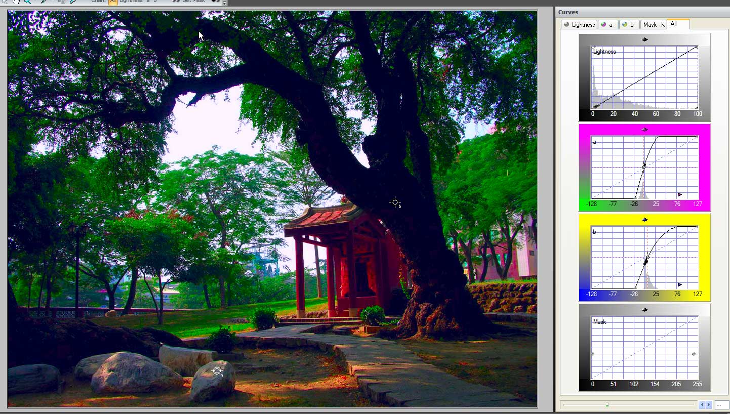

Hello.
I decided to play with the Man of Mars Technique and this image some more. Rather than setting a neutral and making a more realistic image; I decided to take the approach of your solution video and use Pin a Point on the red "house". I may have over-saturated but I wanted to emphasize the effect. What do you think of this image?
I then decided to keep the image above (first screenshot) and add a shadow and neutral; this looks more realistic than the first one. What do you think of it?

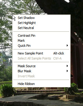

I Pin a Point to the Curve by holding down the CTRL Key and Click with the mouse. For other options such as Set Shadows and New Sample Point (ALT-Click) I can right click on the mouse anywhere on the image and select from the options (see mouse screenshot below), however, I cannot find an option for Pin a Point to Curve - am I missing it? I personally, like to set the points by moving around the image and clicking with the mouse and then selecting the option.
