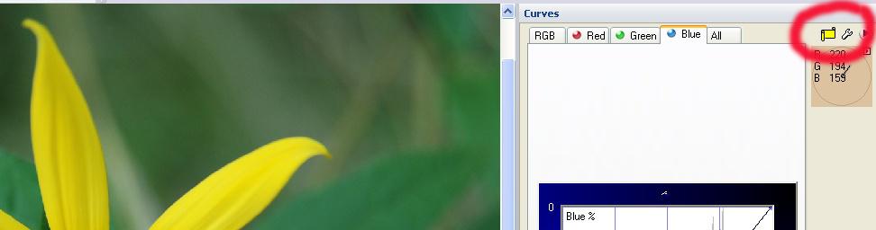

Postby ggroess » Fri Jan 14, 2011 8:53 pm
There is an Icon in CM that is circled in the screen shot below...
It tells CM to play nice with PS on a smart filter...
Unfortunately for this version of CM Mike had to make a few compromises to get this to work...
shot3-jpg-3
shot3-jpg-3 (21.77 KiB) Viewed 8210 times
Postby mikemeister_admin » Sat Jan 15, 2011 11:35 am
Yes, it works if I click on the icon. I was wondering what the purpose of the icon was.
