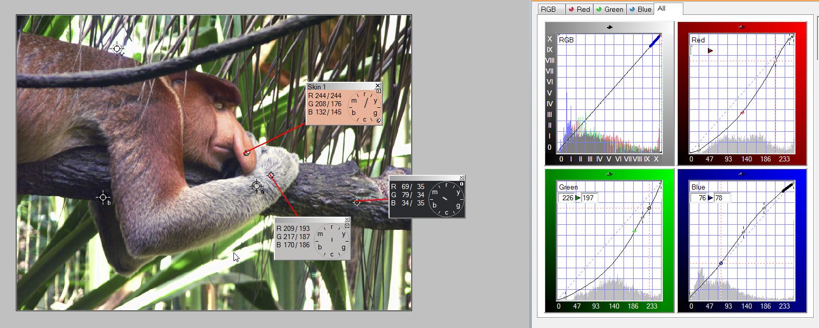

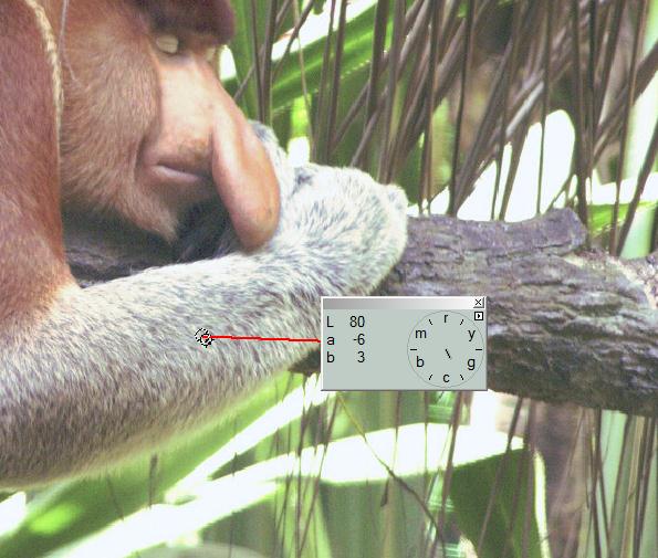

Postby ggroess » Tue Jan 04, 2011 4:40 am
With Green Fur??  hmmmpf...
The LAB version is better but the shadow threshold needs to be set.
The RGB version is well..as I said...green...
screenshot001-jpg-19
screenshot001-jpg-19 (53.94 KiB) Viewed 10512 times

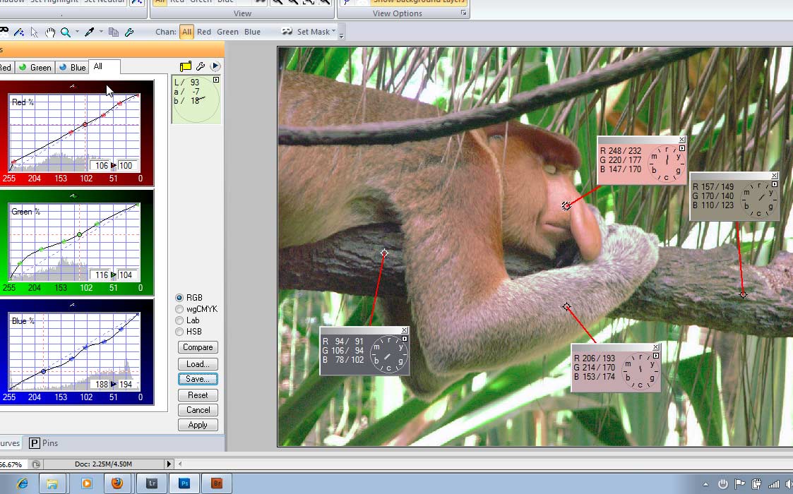

Postby ggroess » Wed Jan 05, 2011 4:45 am
It is looking better but you are still fighting for control of the image...the Skin Pin is the cherry on top.  Remember from the video you need to have a reasonable correction to begin with...the Skin Pin will cause the rest of the image to go all wacky...
In the shot I posted I did a S/H/N then added the skin pin.  After that I made slight adjustments to make the forearm hair look better...
I would suggest that you get the image into a good spot then add the Pin...
screenshot002-jpg-15
screenshot002-jpg-15 (187.82 KiB) Viewed 10512 times

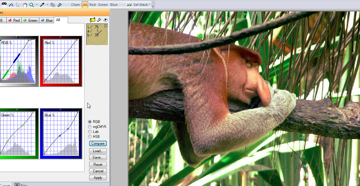

Postby sjordan93436 » Wed Jan 05, 2011 9:06 pm
Here is another attempt.
I noticed something.  When you move the master rgb or the LAB l curve, you can move one channel to zero before the others.  The darkest spot may not be 0,0,0.  When you set a black point, it does equal 0,0,0.
sj34-jpg
sj34-jpg (257.09 KiB) Viewed 10512 times
ss34-jpg
ss34-jpg (281.9 KiB) Viewed 10512 times
Postby ggroess » Wed Jan 05, 2011 9:13 pm
Now your getting it...much better....
