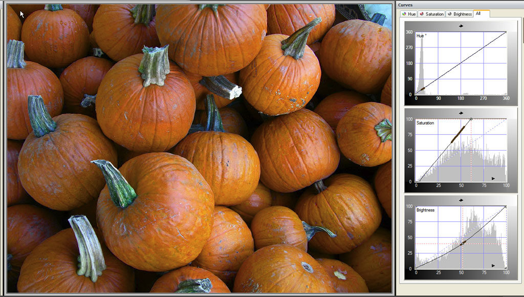

Hello
I have tried the pumpkins again; this time paying closer attention to saturation and brightness.  What do you think?
Thank you
David
20101223_example3_hsb2screenshot1-jpg
20101223_example3_hsb2screenshot1-jpg (163.46 KiB) Viewed 7060 times
Postby ggroess » Fri Dec 24, 2010 11:31 pm
Much better...
I think the greens are giving you trouble but they are hard in HSB.  I would not try for them personally...
Good job.
