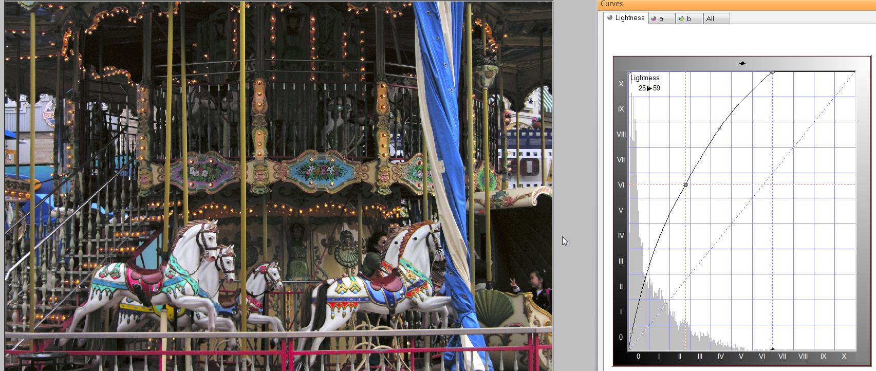

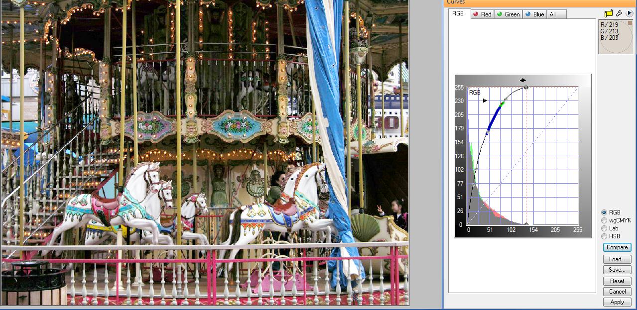

I tried both RGB and LAB, and I prefer the result in RGB. The curves are different and are the result of a bit of trial and error but I couldn't seem to find something that was better.

c1s2-example1-rgb-jpg
c1s2-example1-rgb-jpg (999 Bytes) Viewed 6543 times
c1s2-example1-lab2-jpg
c1s2-example1-lab2-jpg (999 Bytes) Viewed 6543 times

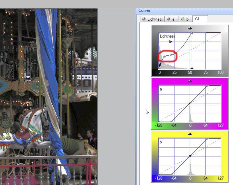

Your LAb curve has a very bad flat spot in it that is causing the muddy appearance in the tonal range.  Shot1
You can get much more out of this image if you do not try to force the tones too much.  Once you have opened the shadows place your mouse on the horses neck and look at the curve line.  Use the worm on the line to help you find the place you need to pull the curve back to bring out the shape of the horses neck.  Shot2
The RGB suffers from the same issue..the flat spot is a bad thing in the master or L channels...
screenshot003-jpg-10
screenshot003-jpg-10 (92.47 KiB) Viewed 6543 times

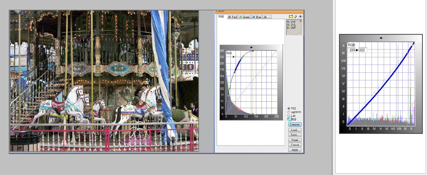

c1s2-example1-rgb3-jpg
c1s2-example1-rgb3-jpg (193.21 KiB) Viewed 6543 times
Postby ggroess » Thu Dec 30, 2010 3:06 am
Richard,
Overall this is much better...Just a slight drop in the Master RGB as shown makes the horse necks have a much better shape.
The flat spots are really bad...Glad you got past it...
screenshot001-jpg-20
screenshot001-jpg-20 (210.21 KiB) Viewed 6543 times
