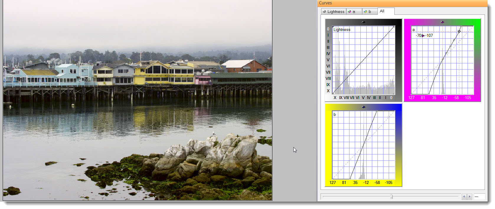

Postby ggroess » Mon Jun 20, 2011 2:34 am
I know by now you are feeling pretty confused...
Let me start by saying you went too far both in the original and in the re-post...
Take a look a the screen shot below.  Notice the control points on the green side of the A channel; they hold the saturation of the greens in check so they do not "over cook" the color too fast.
greg00-jpg-12
greg00-jpg-12 (278.92 KiB) Viewed 16440 times
