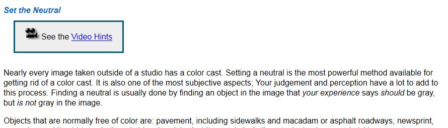

Postby ggroess » Tue Jul 17, 2012 5:03 pm
It is linked through the class assignments page...
See screen shot below....
"Honest Abe" is the actual file name...Sorry for the confusion.
capture-jpg-53
capture-jpg-53 (54.66 KiB) Viewed 9093 times
