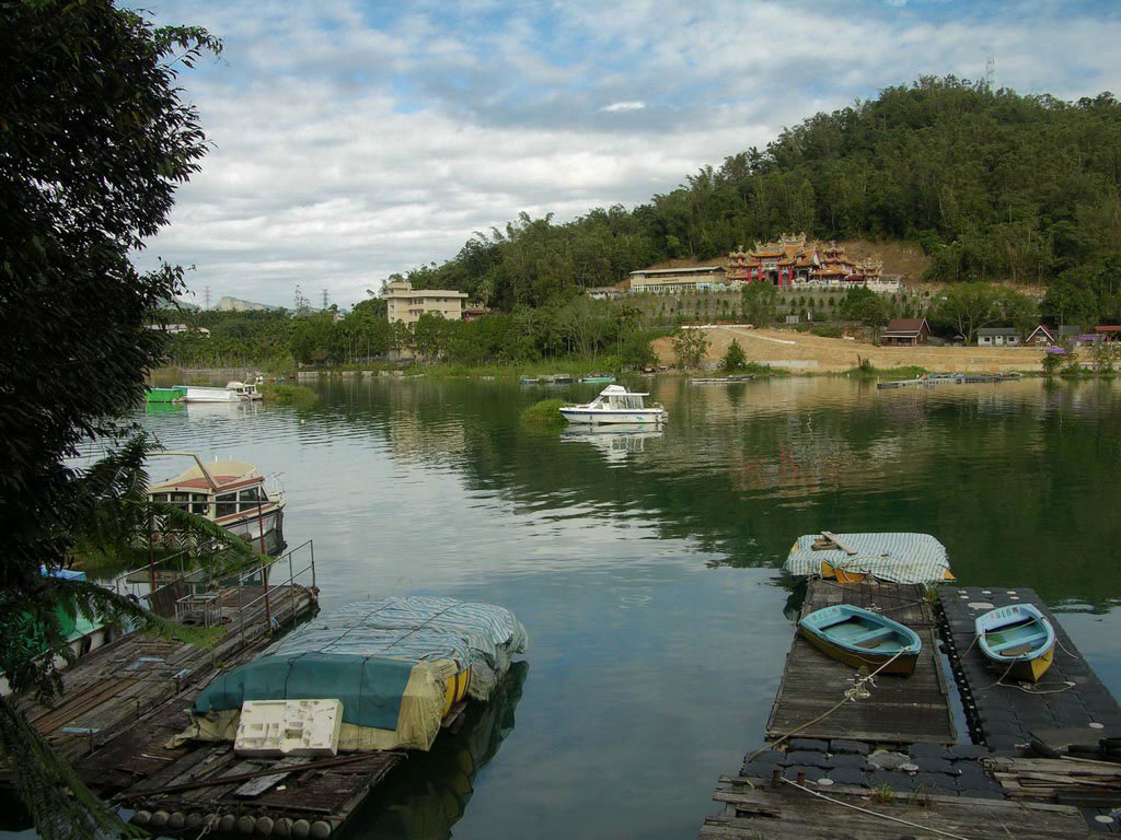

Postby Daniel Zuck » Fri May 03, 2013 5:38 pm
K channel mask with GCR set to 100.  Followed procedure set out in video.  Used lightness channel to control mask blur.  Added 2 extra pin in L curve to bring out detail in clouds

Daniel Zuck
Posts: 130
Postby Daniel Zuck » Fri May 03, 2013 5:42 pm
without accidental erasures

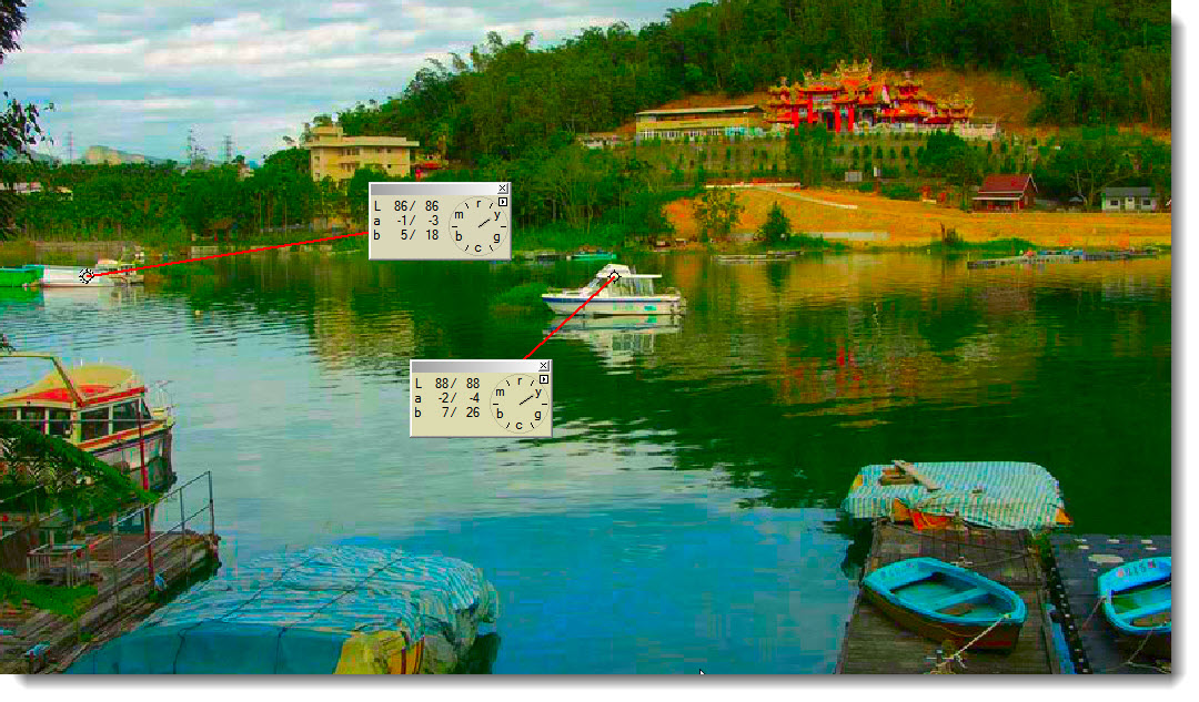

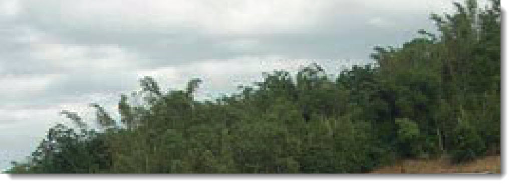

Postby ggroess » Sat May 04, 2013 3:07 pm
Hey Dan,
Two minor issues with this one.
Shot 1 shows the tree line.  The noise might be coming from the mask so take a good look at it to see if you can eliminate some of the edge noise.  try reducing the blur if you can.  Also the image has a slight yellow cast to it...see screen shots below.
