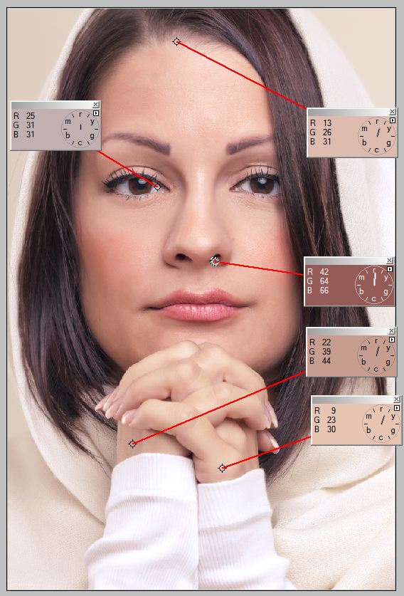

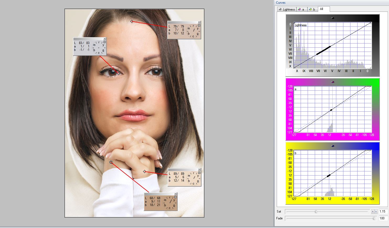

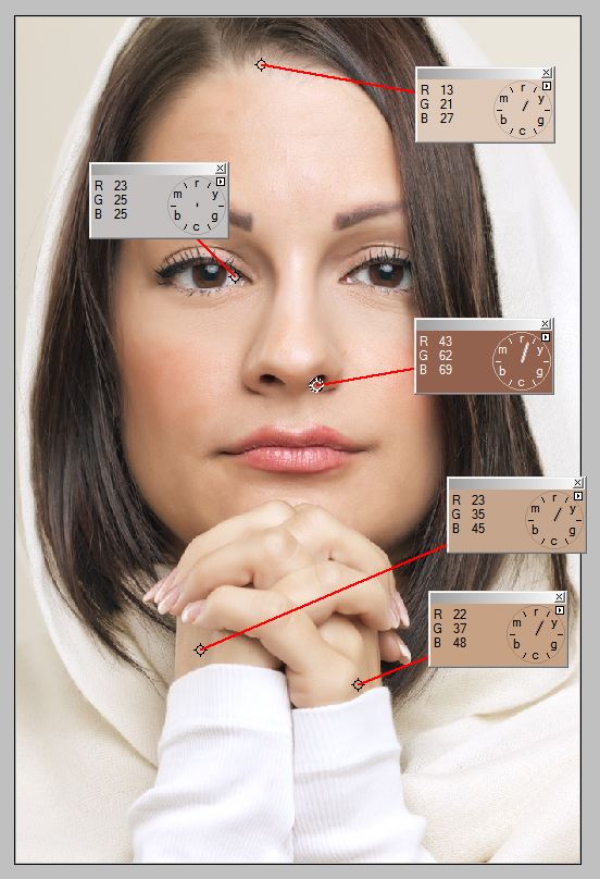

Tanja,
In the images below you see where I would place hue clocks for this image. Notice that none of the hue clocks are in areas with Makeup applied.
If you chose areas with makeup you are not getting skin tones you are getting makeup tones. I do not know what the values should be for that brand and color of makeup so I cannot correct to them. In the first shot the skin tones are reasonable. It looks like you could just do a straight saturation increase and get better overall tone using the saturation slider in LAB. See shot 3
In my portrait work I typically increase the saturation to 1.15 on almost all of my shots after corrections. If it does not look right then we need to go deeper into what you are looking for.
