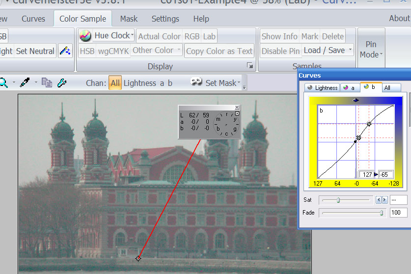

Greg and everybody:
here are some of the screen shots for the ellis island photo.
screen-shot1image-jpg
screen-shot1image-jpg (114.13 KiB) Viewed 12019 times
Daniel Zuck
Posts: 130

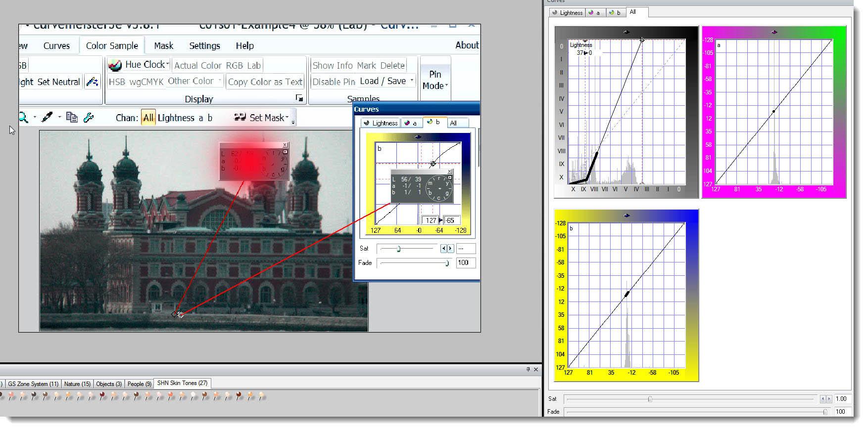

Postby Daniel Zuck » Wed Apr 10, 2013 7:06 pm
Greg and everybody:
here's the screen shot for the b channel
screen-shot2image-jpg
screen-shot2image-jpg (118.31 KiB) Viewed 12019 times
Posts: 327
Postby imported_artmar » Wed Apr 10, 2013 9:37 pm
Hi Dan,
Try placing contrast pins on the L channel on the diagonal at 40 and 60 and rotate to taste.
I think it will look very good.
Daniel Zuck
Posts: 130
Postby Daniel Zuck » Wed Apr 10, 2013 11:32 pm
Hi Art:
Good idea.  Neutral should be between 40 and 60.  will try it . thanks.
dan
Posts: 327
Postby imported_artmar » Wed Apr 10, 2013 11:35 pm
Dan,
No, your neutral is fine -- don't change it.  On the L channel, just click on 40 and then control click on 60 and CM will create two contrast pins that you can rotate.

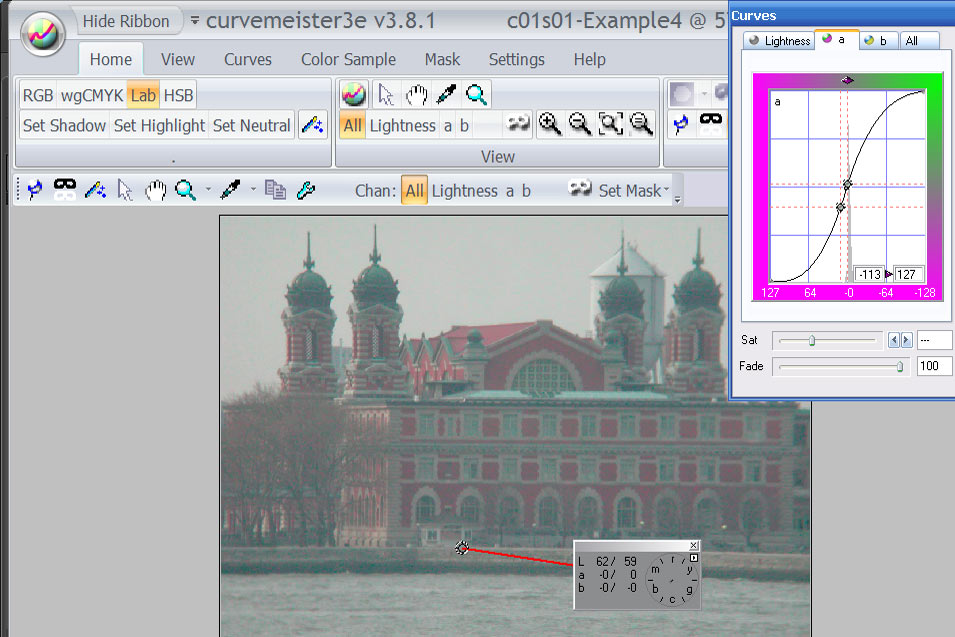

Postby ggroess » Thu Apr 11, 2013 2:12 am
You need to Control Click the second point to make the contrast pin.
Dan,
Just move the endpoints of the LAB L channel as shown.  You really are in a pretty good spot.
greg03-jpg-3
greg03-jpg-3 (214.15 KiB) Viewed 12019 times
Daniel Zuck
Posts: 130
Postby Daniel Zuck » Thu Apr 11, 2013 10:01 am
Greg:
It works.  thanks.
