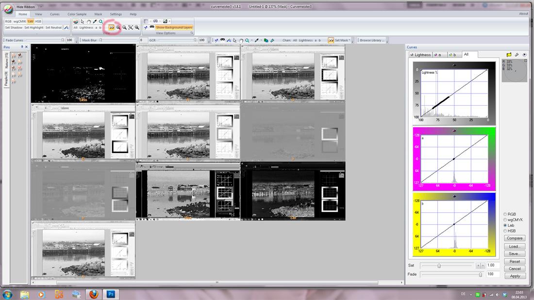

I cannot find any documentation on using the masking feature in CM. If I search for mask in the documentation, it gives tool bars and commands, but no clear explanation that I can find on how it works and what to do. Am I being dense?

Masks in Curvemeister are created from the channels in the image.
Some things to remember....
Here are all the color channels possible in CM:
RGB
CMYK
HSB
LAB
Now, there is a Skin channel as well like we talked about in the video.
So why do you not see all the masks? Color opposites. No need to duplicate a color channel when you can invert another.
For instance, R is the opposite of Cyan.
So an inverted Red channel is a Cyan mask.
Same for Green and Magenta and Yellow and Blue.
The K channel is a representation of Black ink on Paper. You have a GCR (gray component replacement) slider to adjust the density of the black channel which is another "feature" of CM over Photoshop and other tools that use the K channel.
the HSB color space also can create some unique masks to solve specific problems.
Now on to how do we choose...
Remember that masking is about allowing the adjustment to pass through the mask. White areas allow the adjustment to pass through and change the image. Black areas prevent the adjustments from making changes.
So when you look at an image for masking you need to think about what you want to protect or what you want to change. If the main object is something very bright then a K or L channel mask can make a real difference. If it is something very yellow then you want to look at the Blue channel since yellow is the color opposite of blue. There are always going to be exceptions and you do not need to use a mask to fix the problem...they are very powerful and very tempting but many times the image does not need a mask...
For the Lemurs, ask yourself what color are the eyes? Then ask where that color lives in the channels. Remember that a and b of LAB hold the colors for LAB so they can make great masks based on color alone. This is especially true if the rest of the image is a similar tone and may not be separated by brightness. (hint here...)

Part of my confusion may be my lack of Phostoshop skills. I figured out how to create the mask the way I wanted, but then what do I do with it. Is it automatically applied to my layer. It did not seem to be. Do I have to copy it to the Photoshop layer mask? I seem to have missed something somewhere.

As far what to do you can either use the mask inside of cm to make the adjustment needed or you can click on the Copy Channel Icon and then close CM and paste the mask into a layer mask in Photoshop. I think we did this in the weekly video and I am uploading it righ tnow so look for a link later tonight to the video.
You do not need to use a mask unless you feel it is the best way out of the problem. I know that the image does not really require one...
