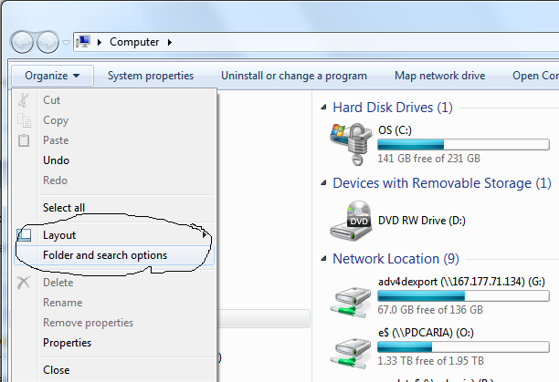

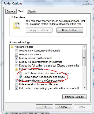

Are you seeing the PSD as well as the RAW? Because if you are the XMP files exist somewhere on your system ACR does not over write the RAW file.
It might be a file manager setting that hides certain file types in windows.
I will have to look into my settings a bit but I go into file manager and turn on all files.
See below:
See below:

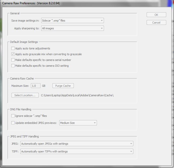

I am seeing the PSD as well as the RAW but I only see the edited raw, not the original.
Am I right in presuming that if I open that again and hit the default button I get back to the original RAW file???
No the "Default" returns ACR to the default settings it is installed with. Have you checked the preferences settings??
See shot 1 Your system may be saving the data to the Raw database rather than the XMP files if that is the case the "Default" might just be resetting the file settings saved in the database.

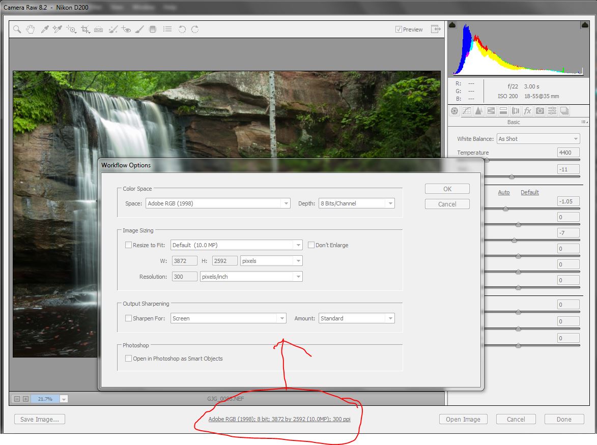

Also, why does it open at 240 rather than 300 ppi?
See Shot 2 you can change the default settings for ACR by clicking on the link circled in the screen shot.
