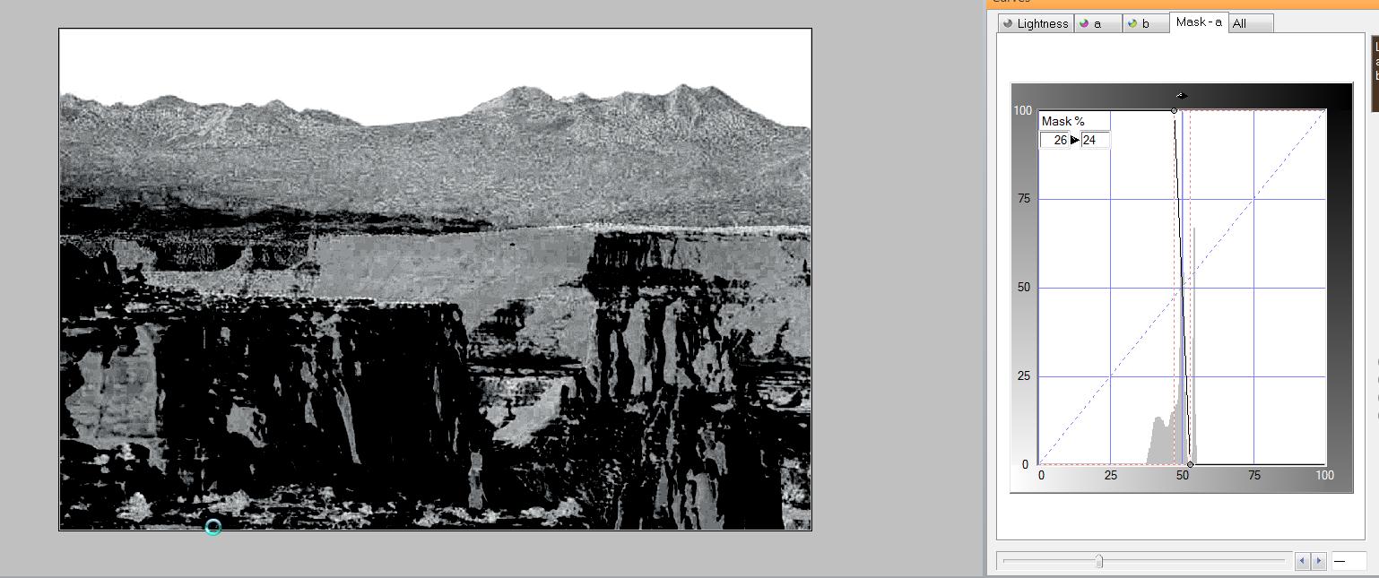

3) In LAB2.acv I adjusted the colors with a saturation slider move through a A channel mask.  I then adjusted the Green to reduce the cyan in the sky and blue to make it look bluer...

screenshot001-jpg-35
screenshot001-jpg-35 (138.18 KiB) Viewed 6571 times
