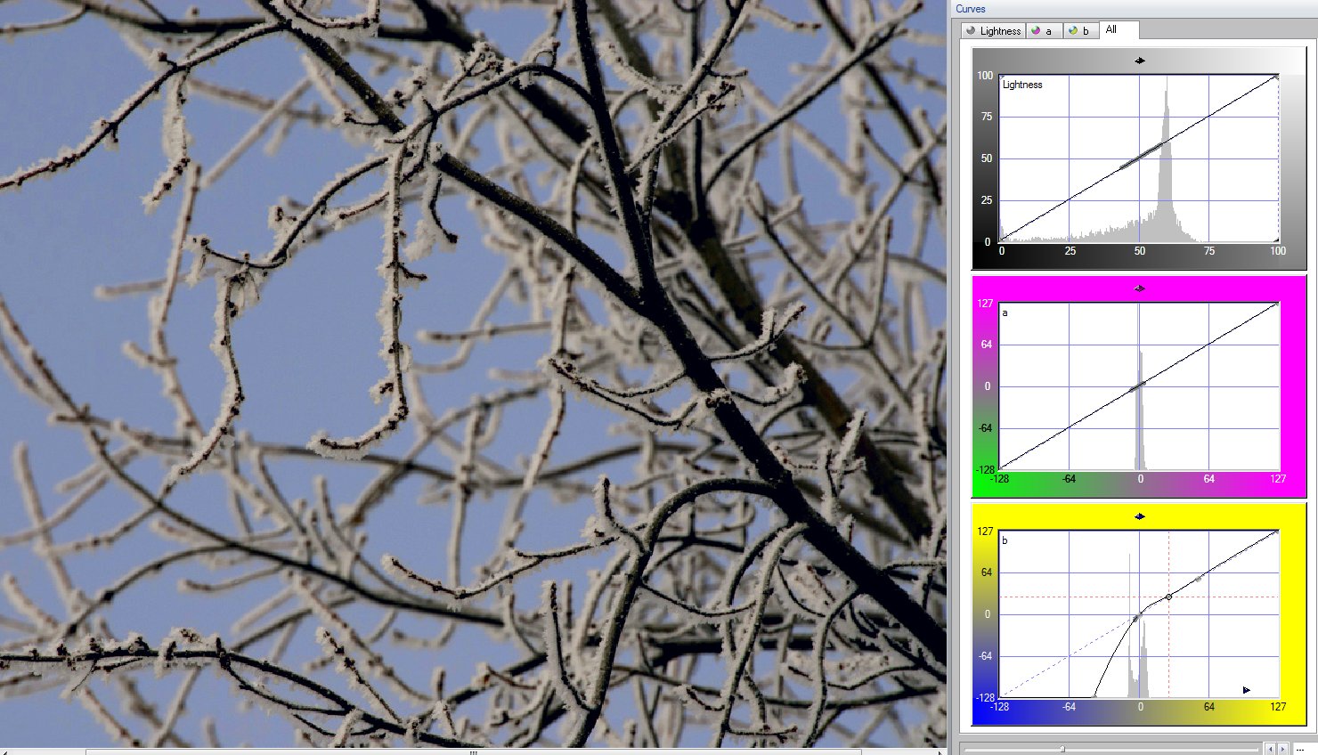

Here's a sugestion.GregM
I  used three dots to anchor the yellow part of the curve.
blue-sky-jpg
blue-sky-jpg (249.17 KiB) Viewed 9939 times

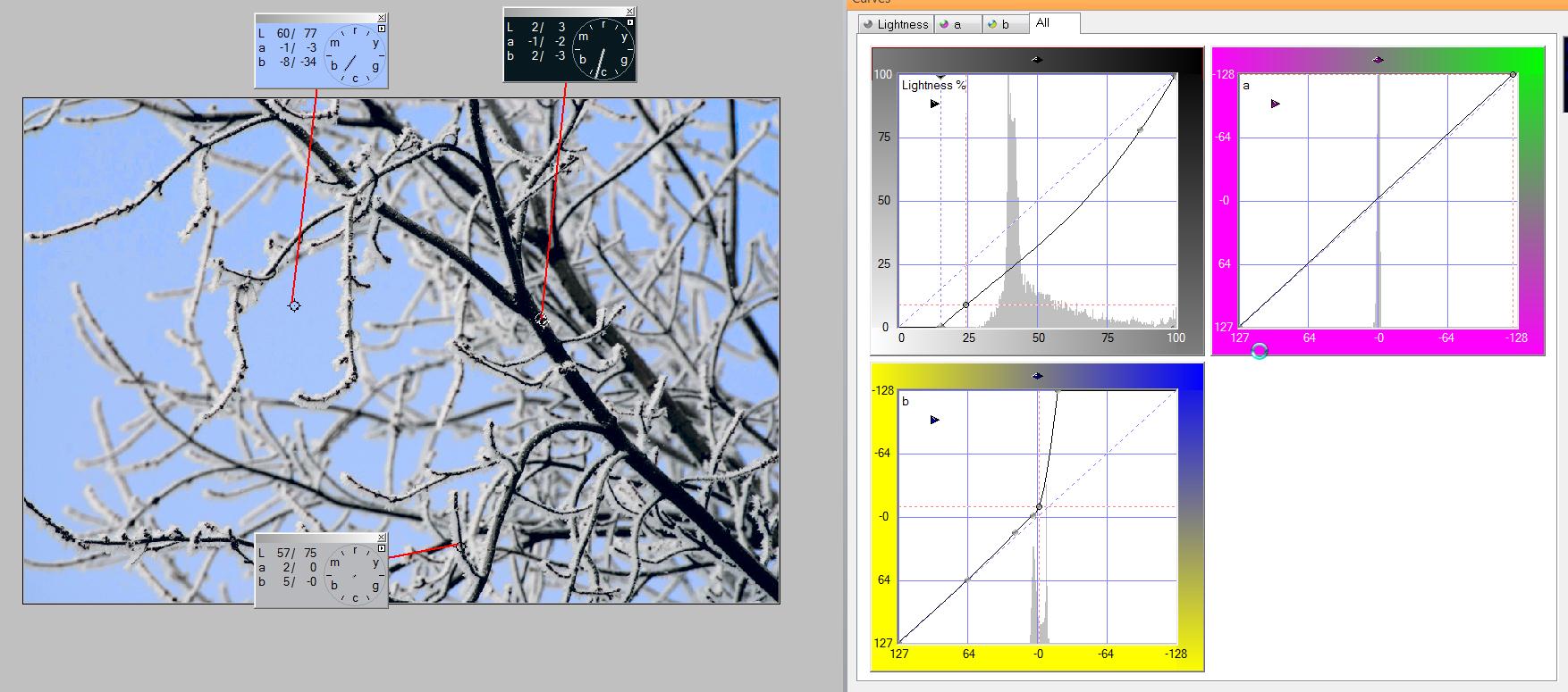

Greg M is correct and you can go further...
Shot1 is the LAB curves applied to your posted image.  I am also posting a .ACV file.  This file can be loaded by Curvemeister so you can see exactly what was done.  Save the ACV file to your desktop and open your posted image in CM.  Switch to LAB mode in CM and click the "load" button.
Examine the B channel and notice that I kept the hoar frost neutral by moving the pint closest to the center of the curve until A and B were zero.  Then I bent the curve as shown.
screenshot001-jpg-32
screenshot001-jpg-32 (178.04 KiB) Viewed 9939 times

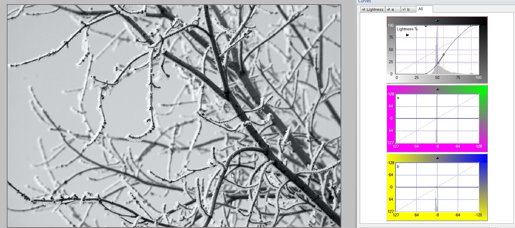

ThomasD
In CM there are a few ways to go Black and white...The fastest is in LAB.  Rotate the curves to be horizontal and adjust the L channel for contrast.
screenshot002-jpg-25
screenshot002-jpg-25 (185.81 KiB) Viewed 9939 times
