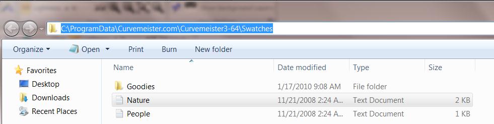

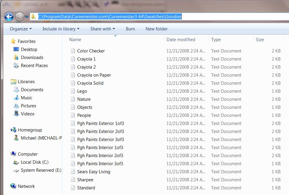

CM installs on Win7: These are from my system...
this is the default install folder. the (x86) part is due to the 64 bit OS I have.
C:Program Files (x86)Curvemeister.comCurvemeister_3
In PSE the the plugin file Curvemeister.8BF should be placed in:
C:Program Files (x86)AdobePhotoshop Elements 8.0Plug-InsFilters
If it is not there but the install completed correctly you can copy it from the 1st path listed above or search the c: Drive to see where it is copied.
see screen shots below for the win7 pin files location.
- screenshot001-jpg-95 (35.42 KiB) Viewed 26567 times
- screenshot002-jpg-73 (96.72 KiB) Viewed 26567 times
