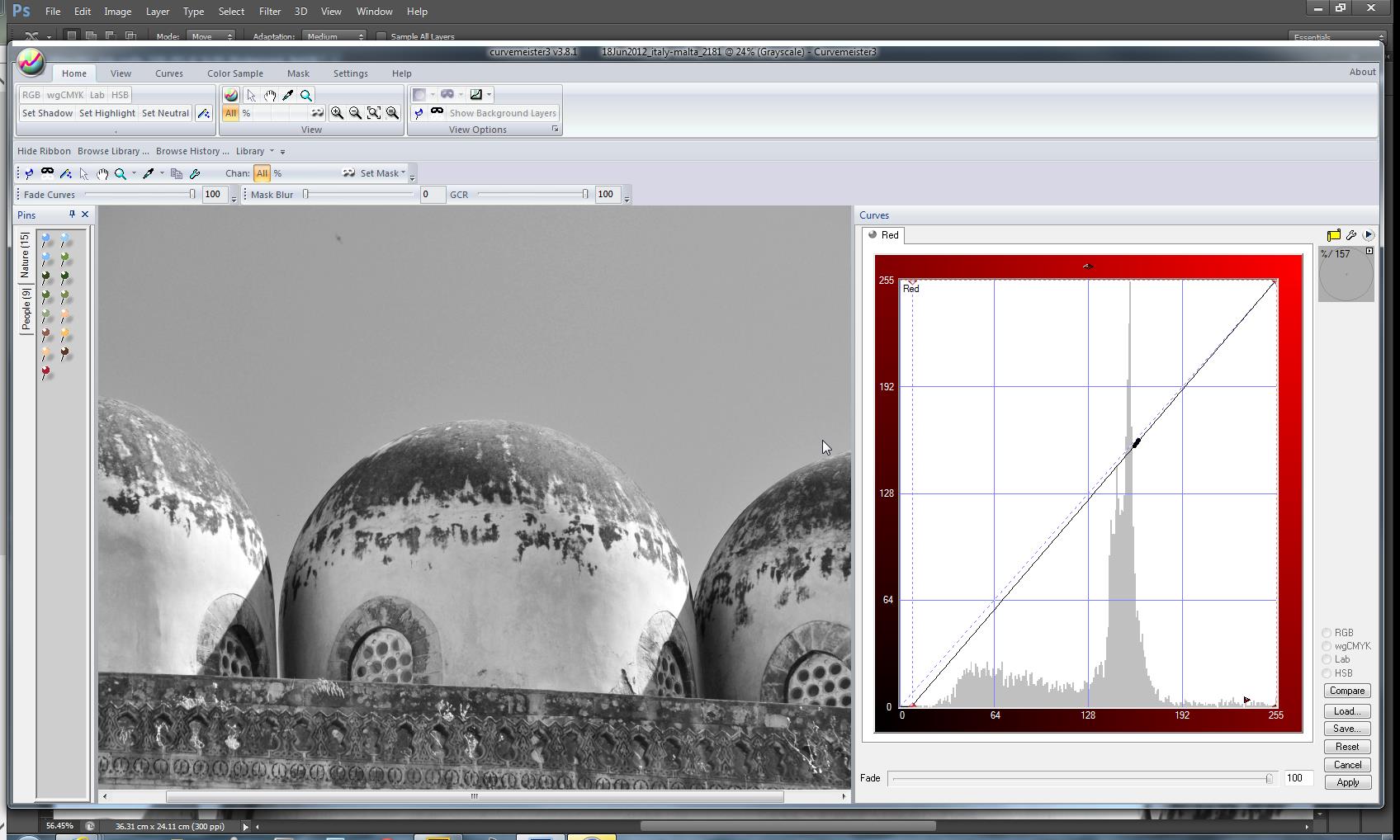

I hope someone can explain something for me
The first step I take in colour correction is to go into the different channels and adjust in curvemeister for luminosity
I have begun to notice how noisy the sky is in many images in the red channel, but not the green or blue
if I end up replacing the blue channel with the red one the noise is really noticeable
Especially when sharpening at the end
I guess I want to know if this is a problem I am creating inadvertently, or if its just the nature of the red channel
Also if anyone has any solutions I would love to hear them
At the moment I am copying the sky into another layer and adjusting for noise - it works, but I wonder why it happens in the first place

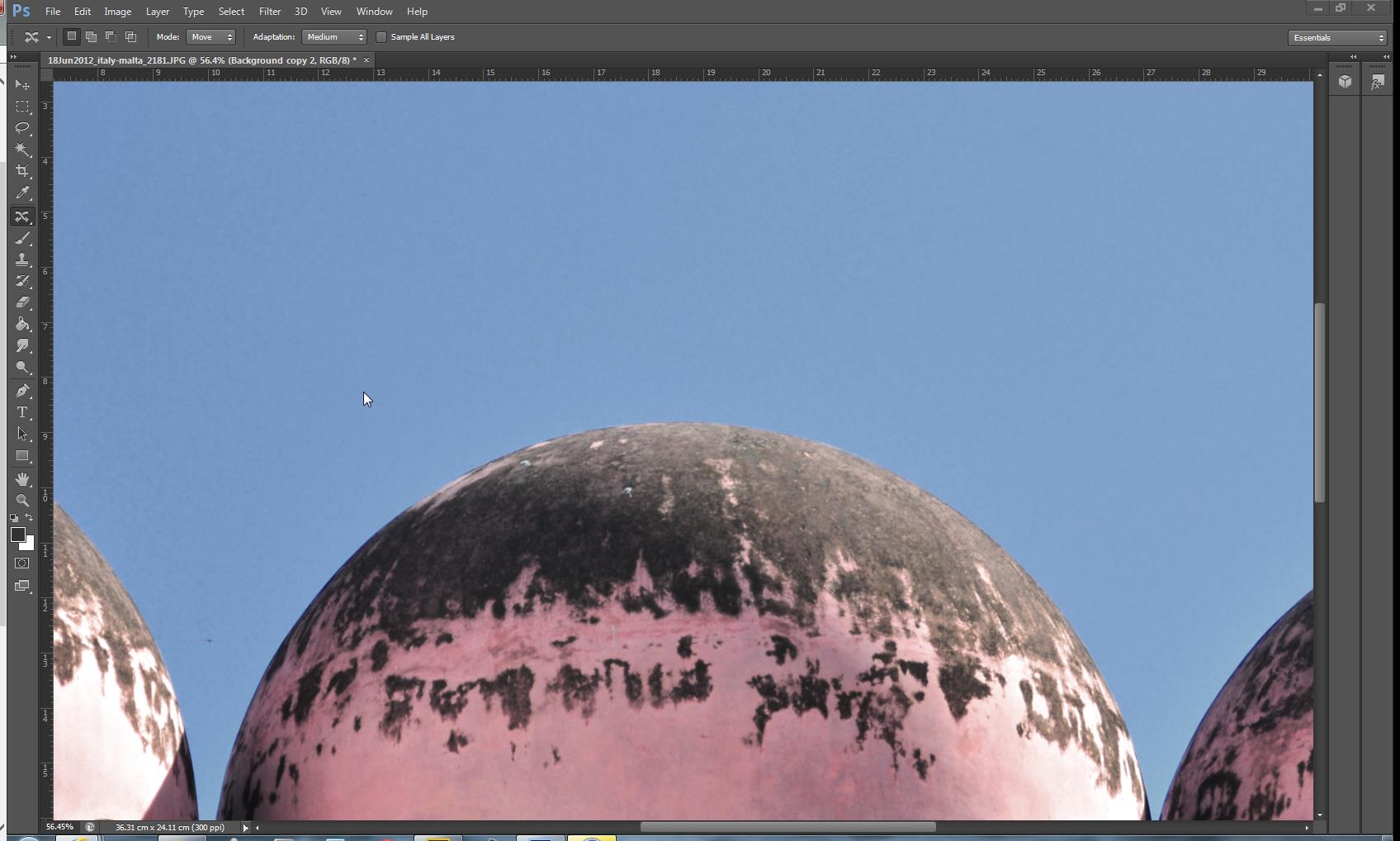

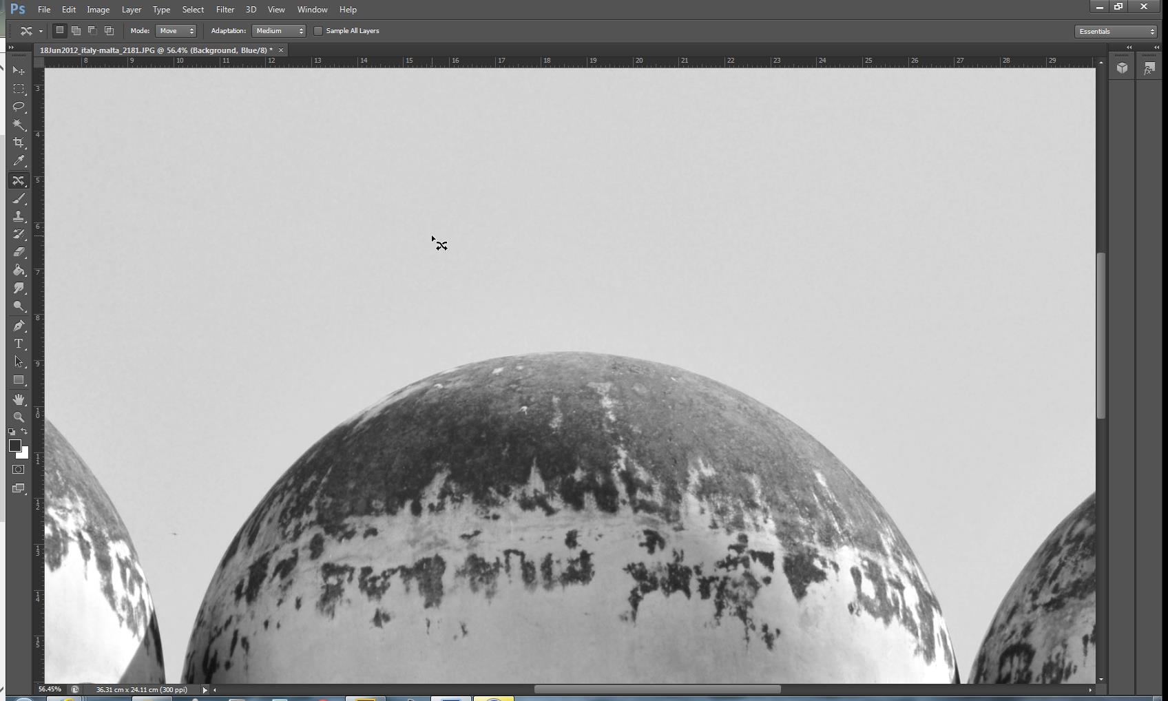

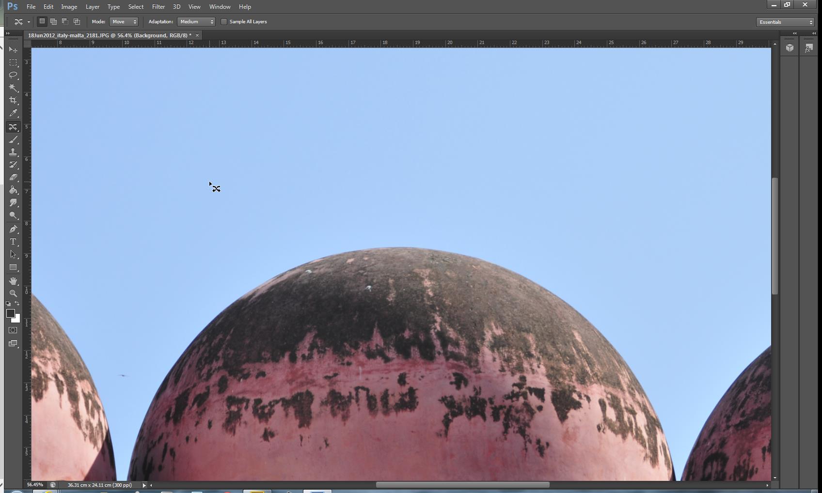

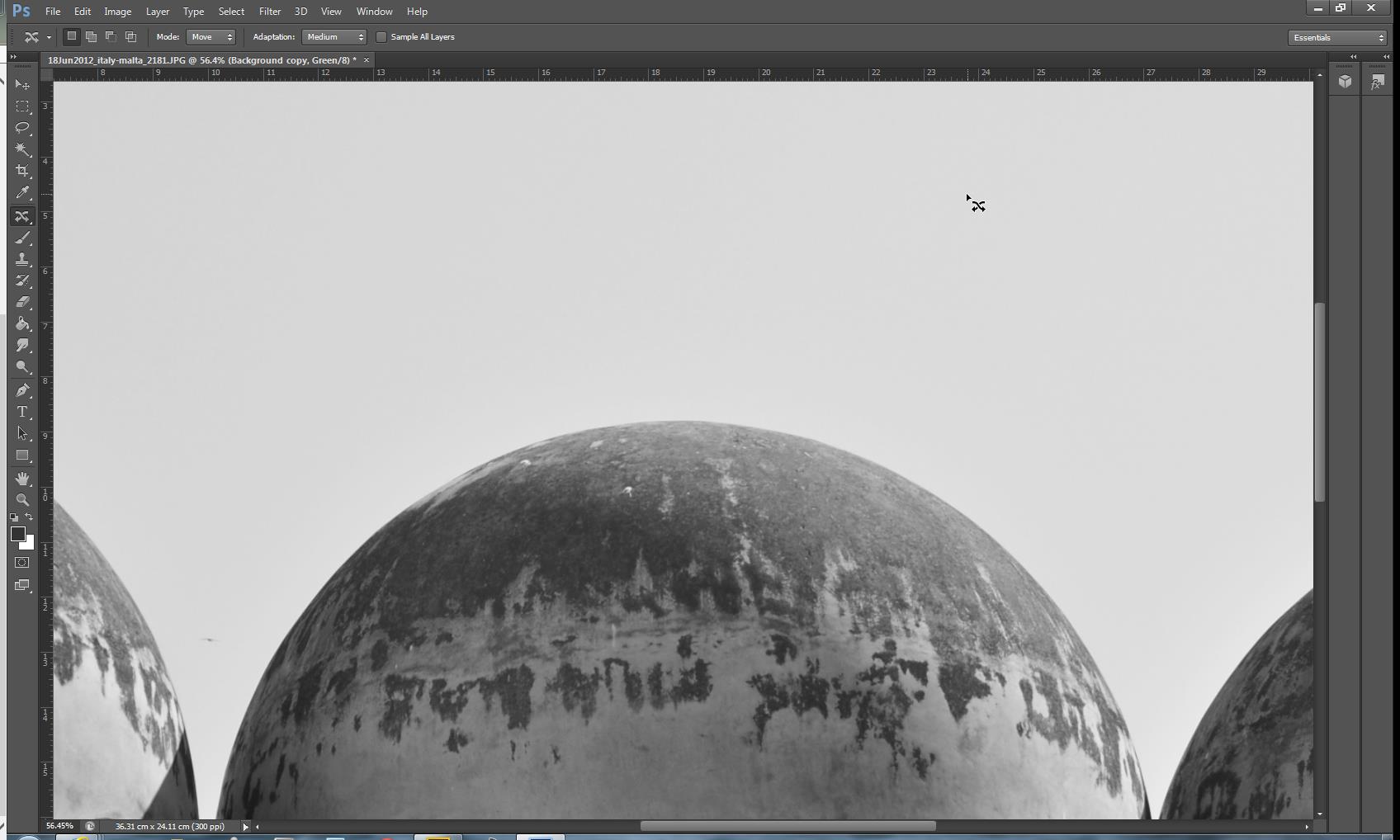

the images attached show the original and all the channels
the original does not have much noise but if I need to replace the blue channel with red or both green and blue with red to increase the luminosity I end up with a very noisy sky
then when I sharpen its worse
This is a harsh adjustment for this image and but I just used it to show what is happening
I can fix it but I just want to make sure its not something I am causing either in my camera or post processing
I am happy to be told I am overreacting and being too fussy
thanks for your time
